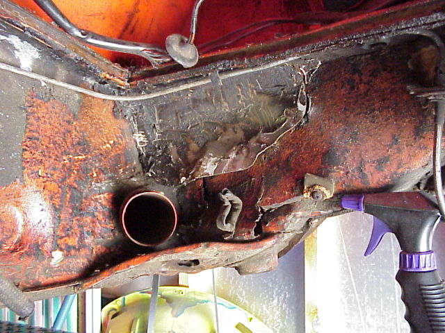

I didn't get a lot done today, but half of the floorpan tar has been scraped off. A lot of time today was burned up removing this sheet someone riveted and bondo'd under the right side engine shelf. I didn't have to do this since this section of the car will be cut off and replaced anyway, but curiousity was killin' me.

Gint   This is the plug on the driver's side front fl...   Apr 18 2003, 08:51 PM
Gint   Near the left rear donut.   Apr 18 2003, 08:52 PM
