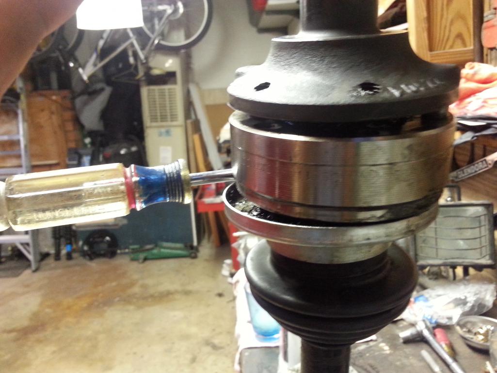

Couple of additional questions for the World though some may have run into.
1. The Type I's have a recess here shown where the boot mates up against the CV.
The fit up isn't great. Should I RTV this side so the boot won't possibly sling grease?
2. Going without the paper gaskets as I have heard stories from others that they will
loosen the bolts over time. Any suggestions on the RTV to use? I was thinking the
most grease resistant and temperature resistant possible.
Thanks all in advance.
