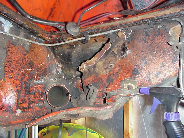

Gint   Another spot of knarly surface rust on the firewal...   Apr 15 2003, 09:12 PM
Gint   See that crack on thje floor pan and the hole in t...   Apr 15 2003, 09:13 PM
Gint   That's concrete you can see through the hole.   Apr 15 2003, 09:15 PM
Gint   I almost forgot to show this pic. The worst of it...   Apr 15 2003, 09:17 PM
Gint   Passenger side rear corner. There is actually a h...   Apr 15 2003, 09:19 PM
Gint   Aha! Now we can see some previous shoddy repa...   Apr 15 2003, 09:21 PM
Gint   Another daylight sighting from interior panels. T...   Apr 15 2003, 09:23 PM
Gint   Although the rust stops at the cross brace on the ...   Apr 15 2003, 09:24 PM

Bleyseng   Most of the rust looks fixable, a real pain but it...   Apr 15 2003, 09:52 PM
Gint   Thanks Geoff. It's not that nice though. Clo...   Apr 15 2003, 10:02 PM
Bleyseng   It's still way less rusty than the 70 car I cu...   Apr 15 2003, 10:18 PM
jonwatts   Gotta love those rust-free California cars! :...   Apr 15 2003, 10:29 PM
Gint   Oh I was tempted all right. But the flip side is ...   Apr 15 2003, 10:50 PM
