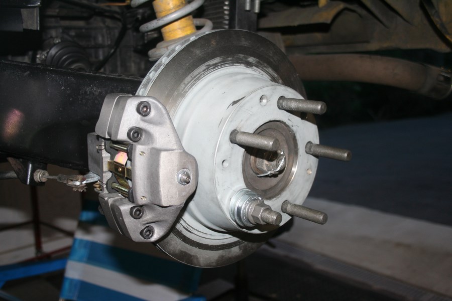

I have PMB's alloy 914/6 calipers on my car. Very easy installation. So far, very happy with them. Good product, excellent support. (IMG:style_emoticons/default/welcome.png)

Socalandy   PMB 914-6GT calipers on my ride with Stock E-brake...   Aug 15 2013, 11:26 PM
