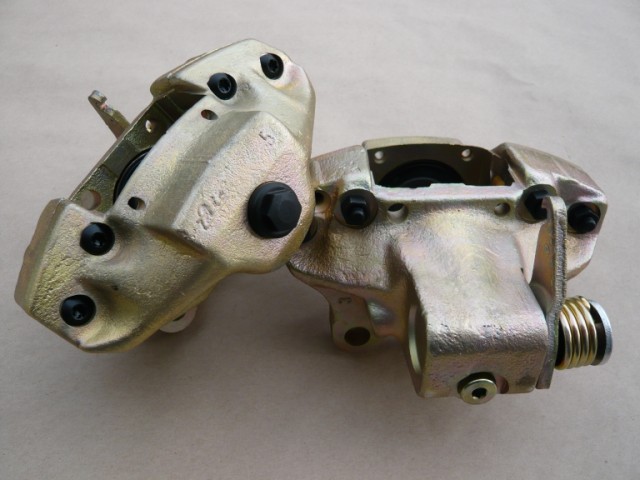

This is, in fact, why we went forward developing the VB914-6 and VB914-6/GT calipers. It's now cheaper to do it right:
If you're a stickler for originality, I have 3 pair of stock 914-6 calipers available @ $1,200.00 per pair:

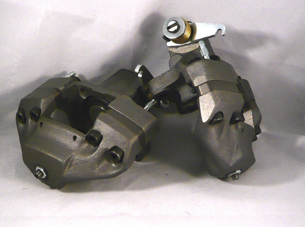

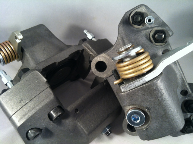

We also have the VB914-6 alloy calipers as mentioned above @ $799.00 per pair:
IPB Image
The 914-6/GT versions would bolt up to your rear vented rotors for $899.00 per pair:
IPB Image
All of these have the same 38mm piston size and the same FSMI D31 pad size your 911 rear calipers have.

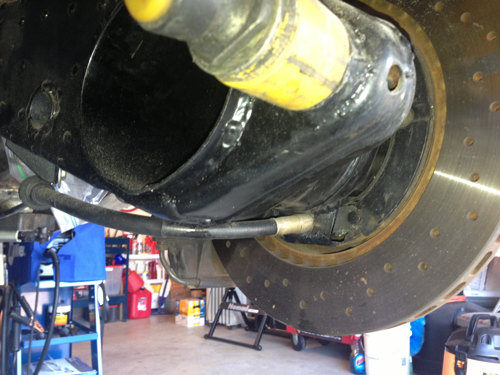

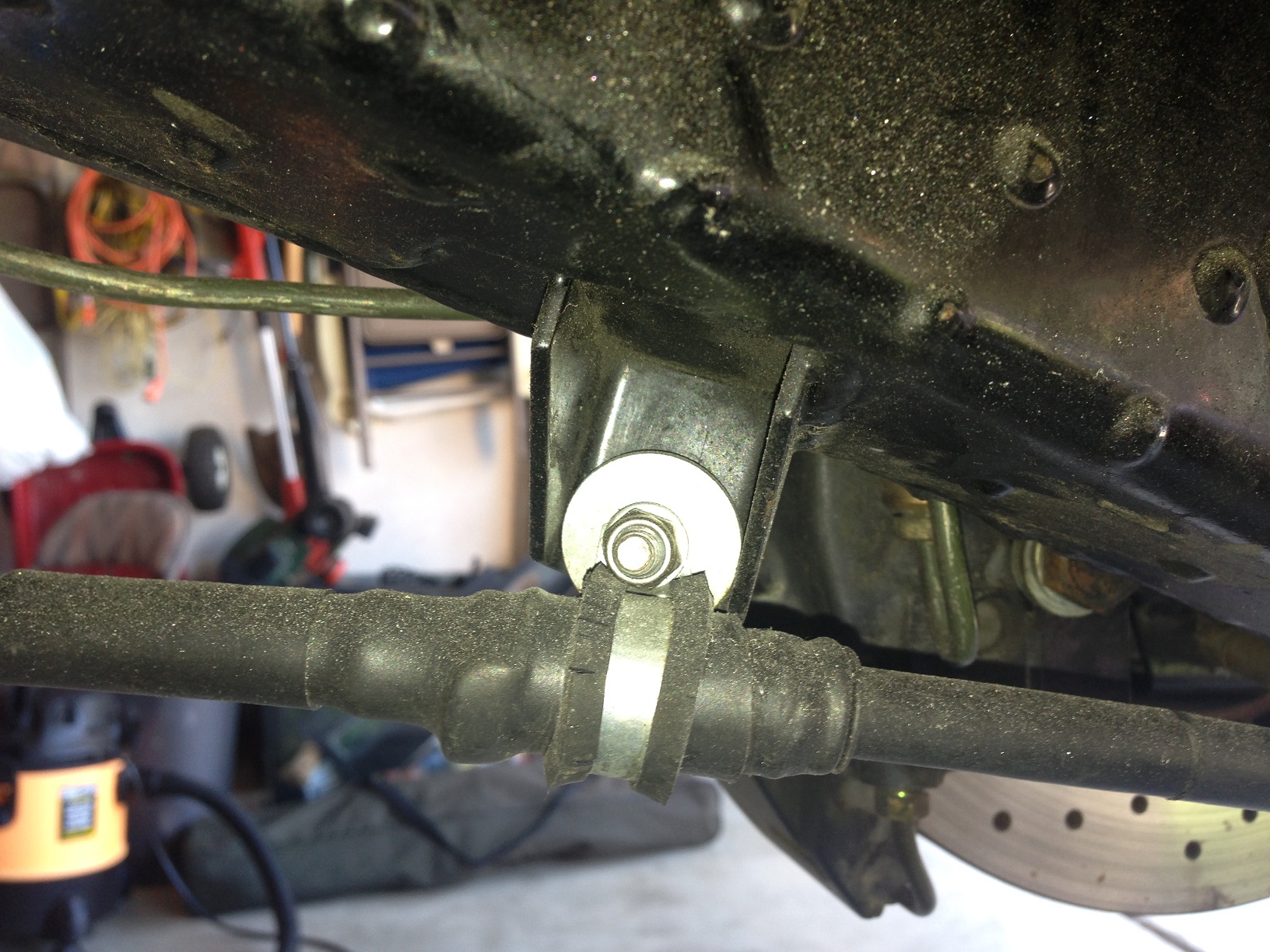

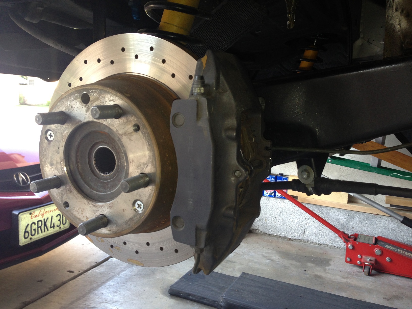

I have PMB's alloy 914/6 calipers on my car. Very easy installation. So far, very happy with them. Good product, excellent support. welcome.png
Socalandy
PMB 914-6GT calipers on my ride with Stock E-brake cables an lines installed in about 20 min. per wheel biggrin.gif
