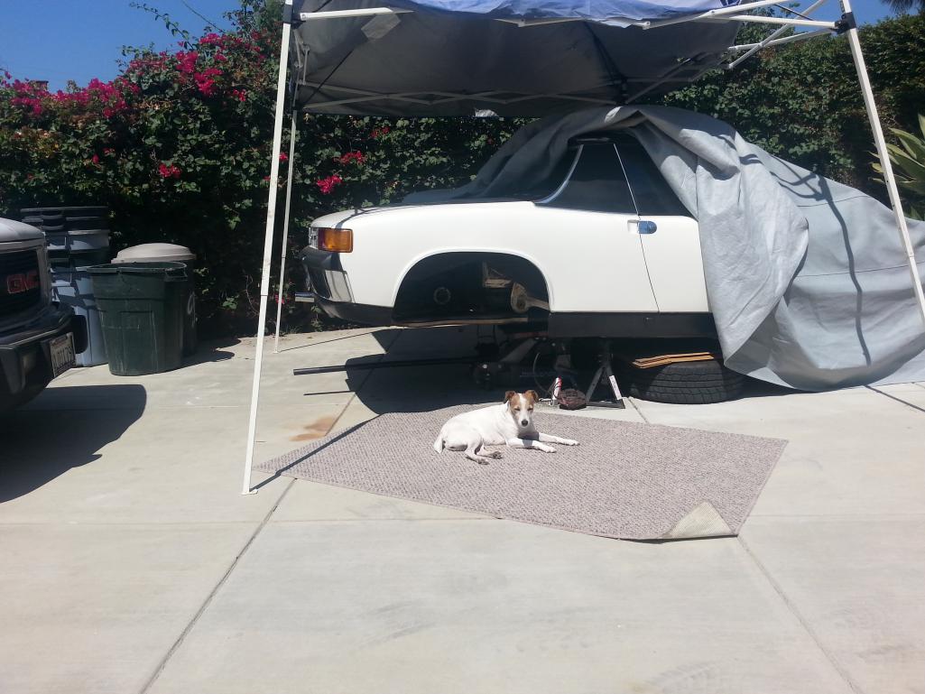

Ok.
Decided to use 500 degree and most grease resistant Permatex RTV...it is black.
Goal is to have the car on the ground....with wheels and suspension in. Gonna replace the trans mounts "while I'm there".
HOT today...shiza..it was cool.
At least I have a helper!
