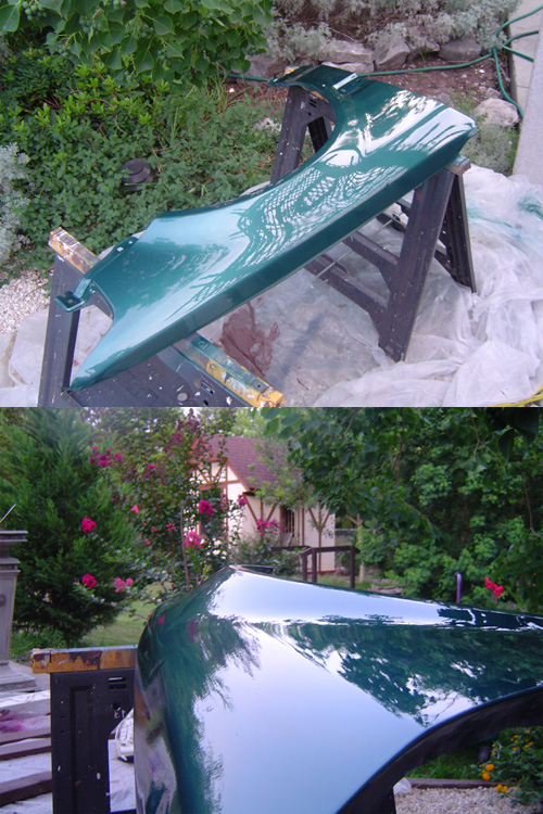

Ok, here are the results of my first day with the Devilbiss G670 gun. I must say I am very impressed with this gun.
Setup:
Sears Compressor - 33 gal.
Air guage set at about 35psi at the gun.
1.4mm fluid tip installed.
I used a fender from a 92 Accord, sanded it down with 400.
I sprayed Sealer, base coat, and 2 coats of clear.
This is the second time I have ever sprayed anything on a car. My other gun is a Sears conventional gun, and I can already tell this gun blows it away. It lays paint down nice and smooth, and is very efficient. I was able to do several coats on this fender without my compressor kicking on. I remember when I used the Sears gun, there would be overspray everywhere, and a mist of paint in the air, but this gun just lays it down, and it dries fast. Very sweet.

Brett W   Looks like you got some orange peel or dry spray i...   Jul 16 2004, 09:02 PM
thomasotten   <...   Jul 16 2004, 09:16 PM
Brett W   Yes lots of american cars have really bad orange ...   Jul 16 2004, 09:41 PM
Mark Henry   I have both a high end Devilbiss HVLP (can't r...   Jul 16 2004, 10:15 PM
