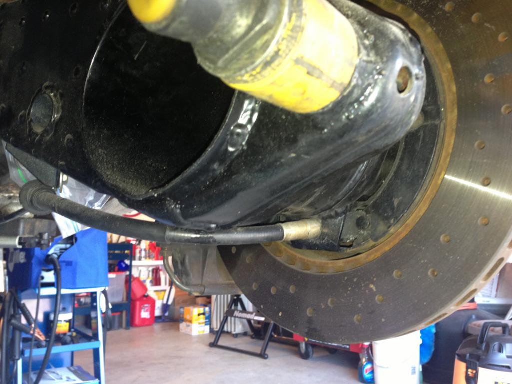

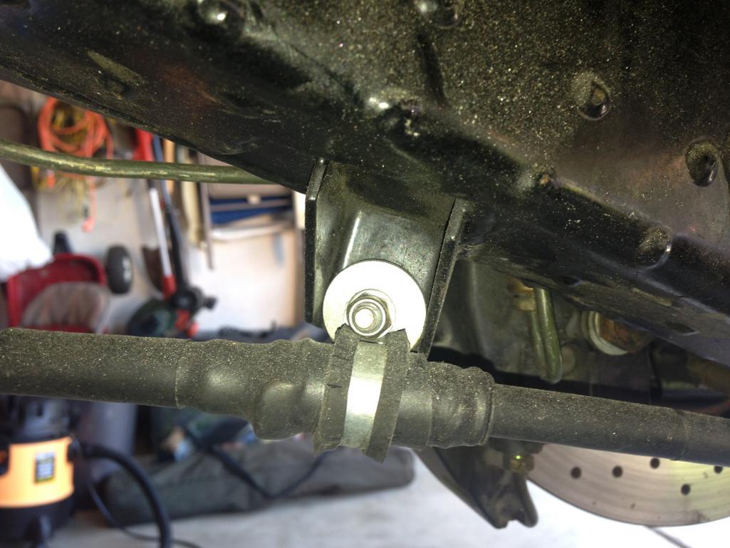

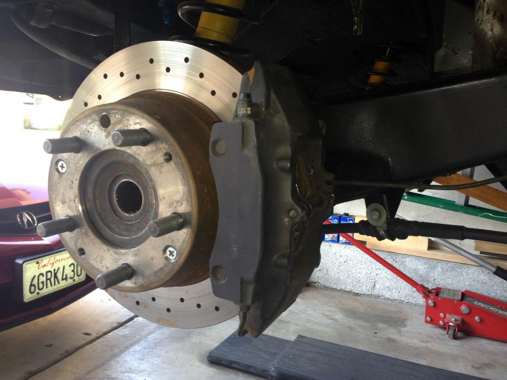

Eric's solution is the way to go. IMHO, to go with 911 rear e-brakes you need to weld a hefty stopping brace to the trailing arm, let alone the additional cable mods. I had Wes (rip) weld some thick braces to my trailing arm. Similar size and structure to a 911 trailing arm. I then used early 911 e-brakes and Boxster rear brakes. For the cables, I used modified 914 clutch cables. It only pulls from one side, but works fine. Regarding the brace there is a bolt on available, but I am curious how strong it is in case of an emergency. If your going 60 plus miles an hour and yank on the emergency brake, will it rip off? The brace prevents the shoes from ripping apart and spinning on the axle. I only went with this solution because Eric's solution wasn't available at the time.
