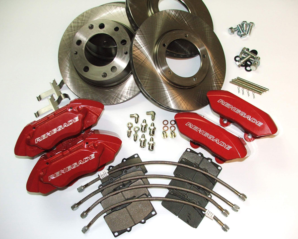

I currently have the Renegade "Big Red" caliper setup on my car. I don't know what the specs of the rear caliper are. I presently don't have a handbrake. I will want one when my car hits the street. Is my best bet at this point to go the 911 route (Tangerine)? Should I use the 914/6 GT calipers on the rear, would I lose the proper balance mentioned by Eric? Does anyone have any experience with the kit I'm using, is it properly balanced?
Thanks, Walt
(IMG:http://www.914world.com/bbs2/uploads_offsite/www.renegadehybrids.com-11463-1376914540.1.jpg)

Eric_Shea   I currently have the Renegade "Big Red...   Aug 19 2013, 07:38 AM
