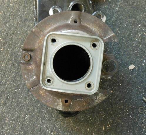

Shave the shiny areas until the hat/ backing plate sits flat on the bearing housing.
I did not have to oval the holes -they were perfect.
Makeshift bearing retainer for visual puposes.

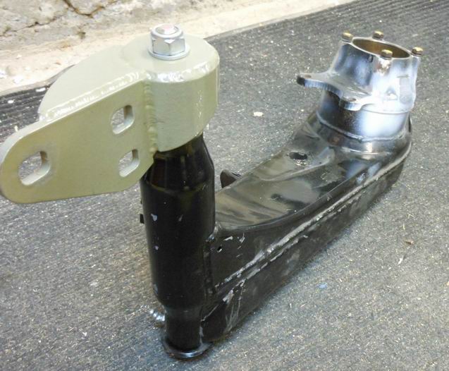

Jeff Hail   First pic to give an idea what the 11 arm looks li...   Aug 19 2013, 07:57 PM
