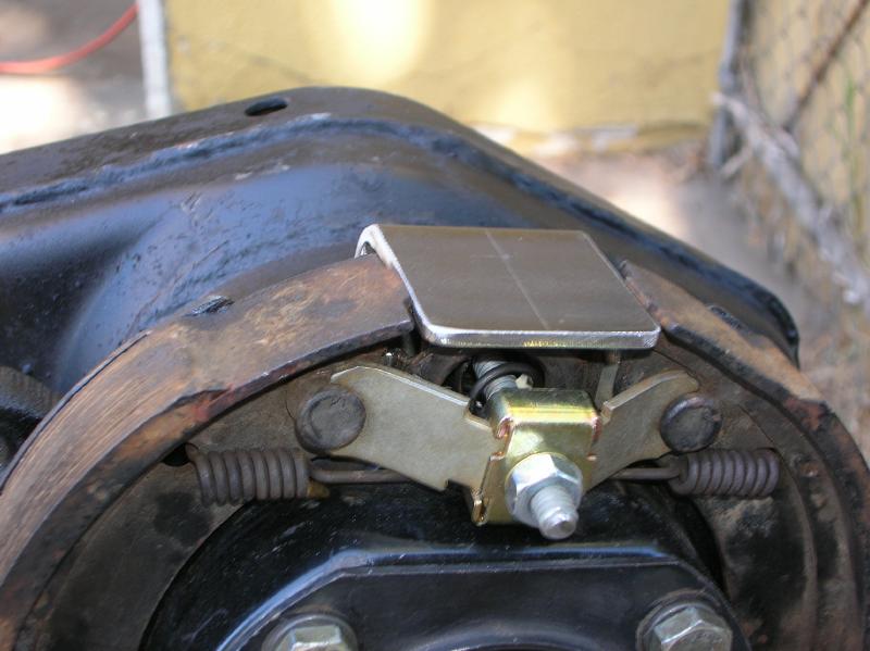

First pic to give an idea what the 11 arm looks like with the 40mm anti-rotation block.

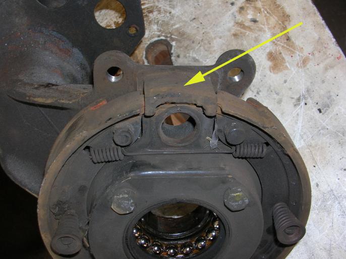

Second pic is one of Wes's mods with the inverted hat.
