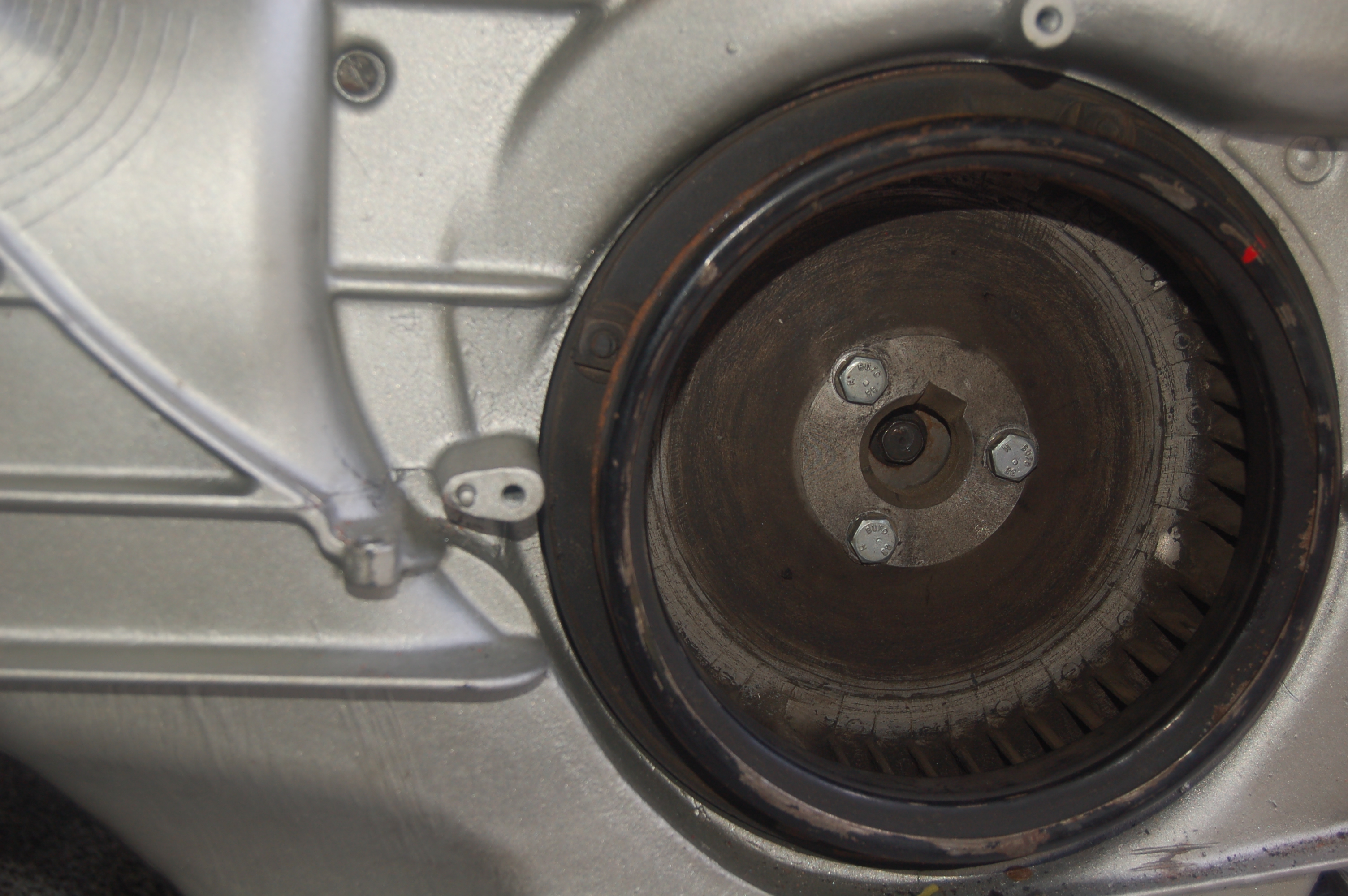

Anyway, dropped the motor this morning and I don't know if I should start at the front or back first?
Picture is of the front. I pulled those three bolts to see what they looked like on the ends and they look fine.
SO, I'm thinking to start in the back by pulling tranny.
Will do that after lunch.
But tell me if those three bolts that hold the cooling fan on look OK on the ends, is it safe to assume the front isn't where I should be looking.
Mindful the flywheel was new according to the PO - so me thinks the back is where the issue may show up.
Thanks,
Len

Take the pulley off! Make sure there is a washer (spacer) behind it!

lsintampa   Here's that fork I was talking about. This po...   Aug 22 2013, 02:13 PM
ThePaintedMan   Len, no indent on any of my clutch forks. Is you...   Aug 22 2013, 02:35 PM
