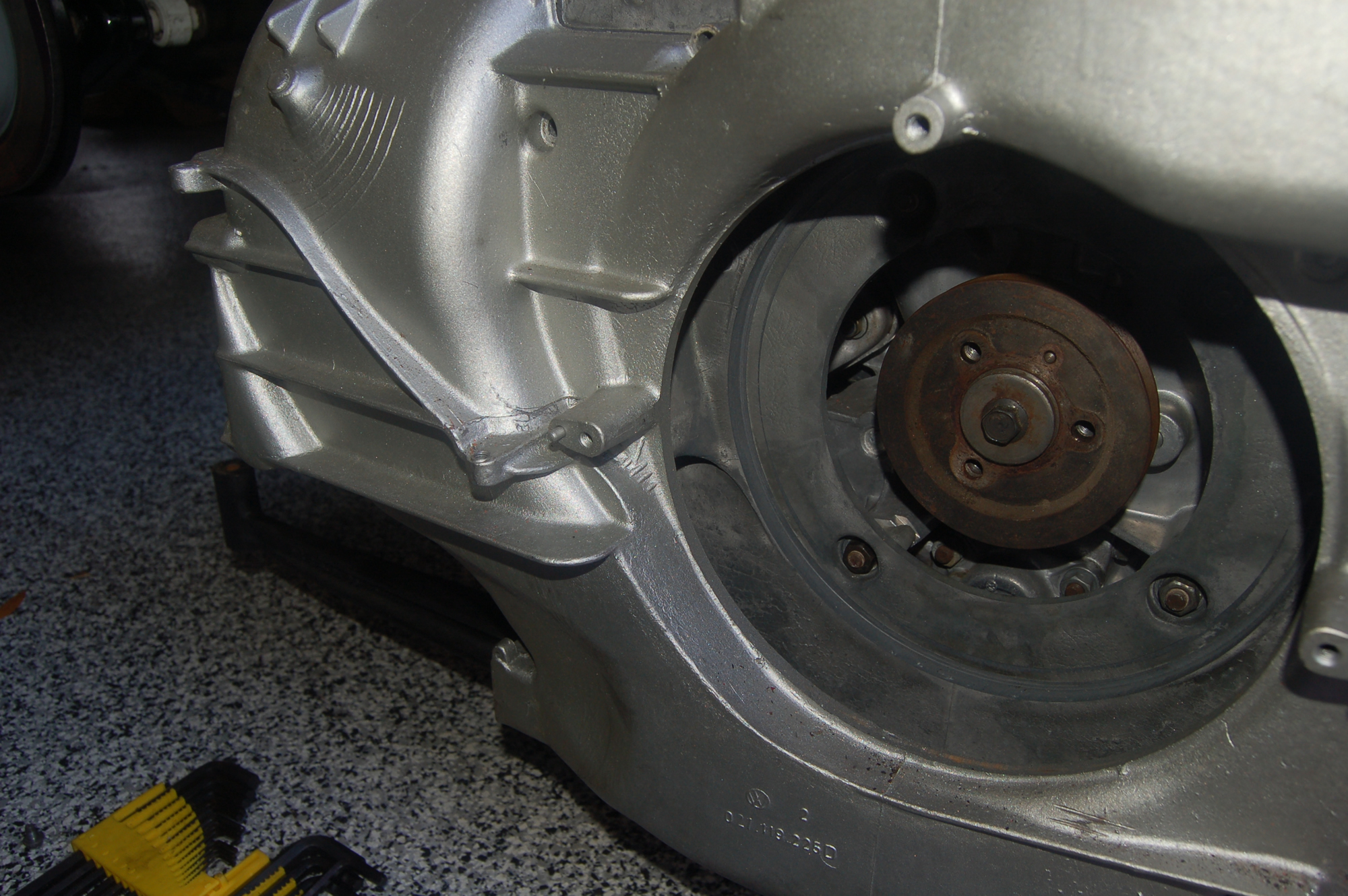

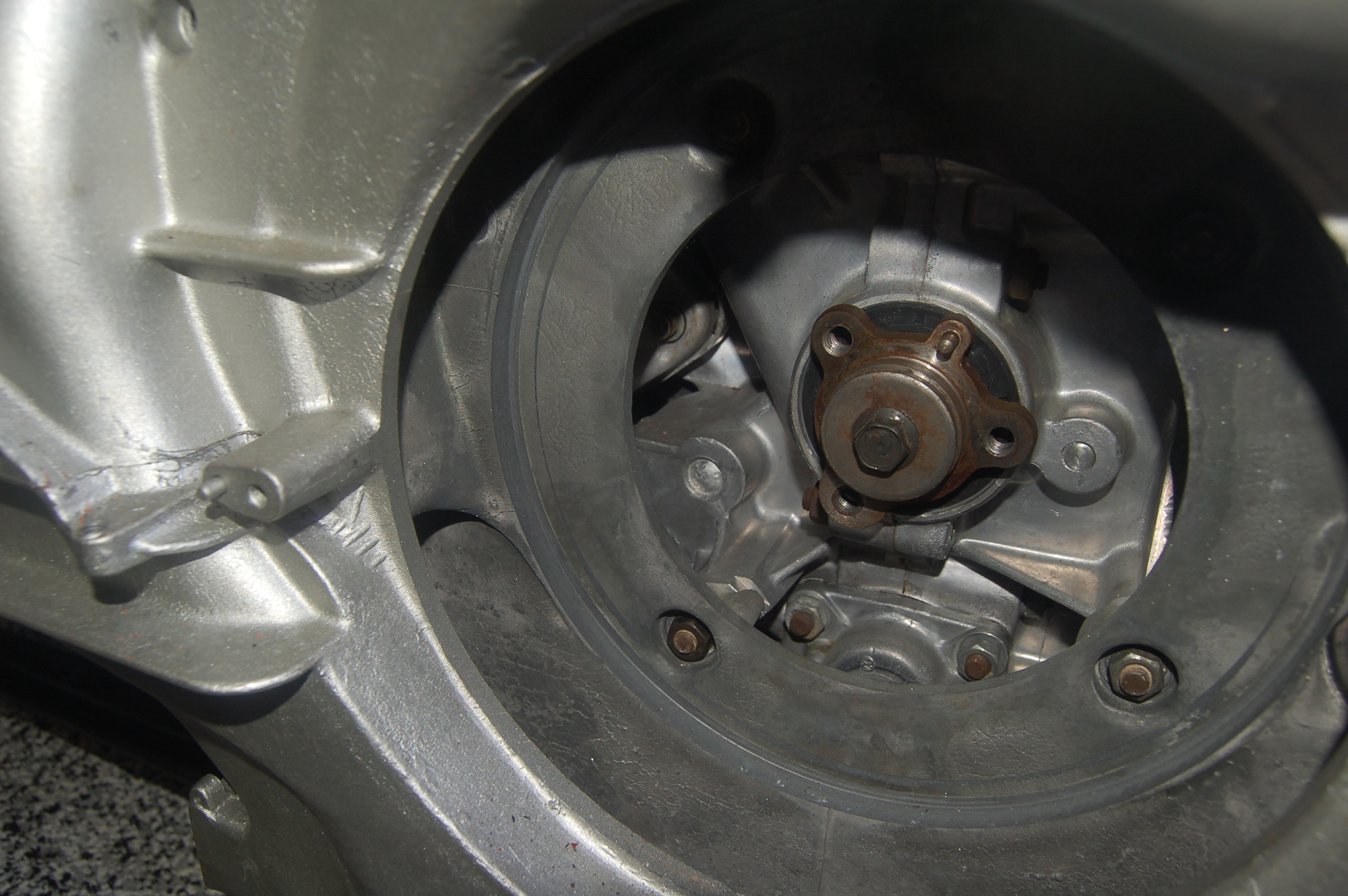

lsintampa
post Aug 20 2013, 12:10 PM
Posts: 520
Joined: 28-January 13
From: Tampa, FL
Member No.: 15,441
Pulled the fan pulley off.
There wasn't any spacer behind it, but there was another pulley behind it.
Pulled the second pulley off - still no spacer.
Not sure what that second pulley is for? There doesn't seem to be anyway to get a belt on it that would go anywhere????
It was a CA car and had AC - but IDK what the smaller inside pulley would be for.
Mysteries abound.
See photos...

ThePaintedMan   Take the pulley off! Make sure there is a was...   Aug 20 2013, 12:04 PM
lsintampa   Pulled the fan pulley off. There wasn't any s...   Aug 20 2013, 12:10 PM
ThePaintedMan   That looks like it was supposed to be there to dri...   Aug 20 2013, 12:18 PM
Java2570   Cars with AC had that pulley installed behind the ...   Aug 20 2013, 12:18 PM
