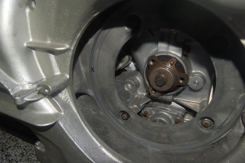

Bartlett 914
post Aug 20 2013, 03:14 PM
Posts: 2,218
Joined: 30-August 05
From: South Elgin IL
Member No.: 4,707
The "X" marks the ring I am seeing.

lsintampa   OK, Minor success, but there has to be an easier ...   Aug 20 2013, 01:36 PM
Bartlett 914   You can see in your picture the fan was rubbing...   Aug 20 2013, 01:44 PM
lsintampa   You can see in your picture the fan was rubbing...   Aug 20 2013, 01:52 PM
ThePaintedMan   I don't see that... but then again, there is v...   Aug 20 2013, 01:53 PM
Bartlett 914   I don't see that... but then again, there is ...   Aug 20 2013, 02:03 PM
lsintampa   I don't see that... but then again, there is...   Aug 20 2013, 02:16 PM
The Cabinetmaker   One more for seeing no scraping marks.   Aug 20 2013, 02:58 PM
Bartlett 914   The "X" marks the ring I am seeing.   Aug 20 2013, 03:14 PM
Java2570   If your crank end play is out of spec, it can easi...   Aug 20 2013, 03:18 PM
stugray   http://www.914world.com/bbs2/uploads_offsite/i366....   Aug 20 2013, 03:19 PM
The Cabinetmaker   Fresh scraps will leave shiny metal. That does not...   Aug 20 2013, 03:28 PM
ThePaintedMan   :agree: It's not shiny, it's just the wa...   Aug 20 2013, 03:36 PM
