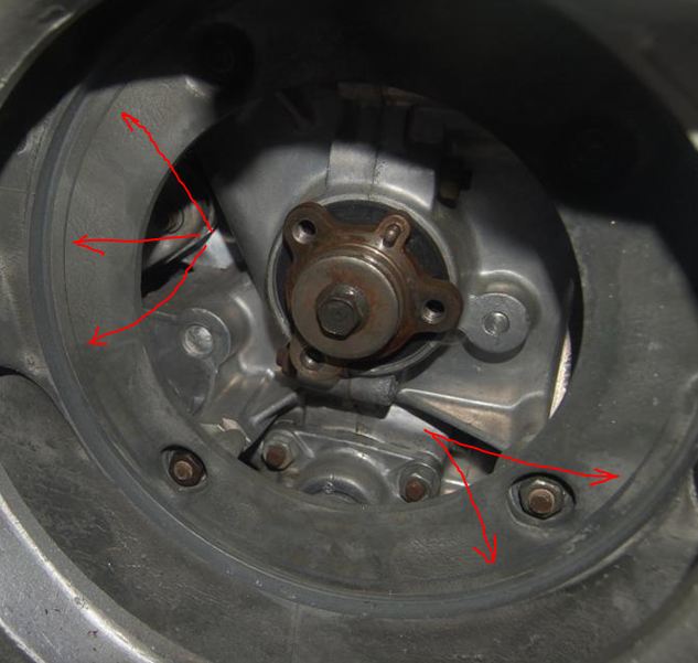

(IMG:http://www.914world.com/bbs2/uploads_offsite/i366.photobucket.com-10819-1377033543.1.jpg)
They are more like "scuff" marks.
I have seen far worse where there were chips inside the housing.
That time you could CLEARLY tell where the noise was coming from.
Stu

lsintampa   OK, Minor success, but there has to be an easier ...   Aug 20 2013, 01:36 PM
Bartlett 914   You can see in your picture the fan was rubbing...   Aug 20 2013, 01:44 PM
lsintampa   You can see in your picture the fan was rubbing...   Aug 20 2013, 01:52 PM
ThePaintedMan   I don't see that... but then again, there is v...   Aug 20 2013, 01:53 PM
Bartlett 914   I don't see that... but then again, there is ...   Aug 20 2013, 02:03 PM
lsintampa   I don't see that... but then again, there is...   Aug 20 2013, 02:16 PM

Bartlett 914   The "X" marks the ring I am seeing.   Aug 20 2013, 03:14 PM

The Cabinetmaker   Fresh scraps will leave shiny metal. That does not...   Aug 20 2013, 03:28 PM
ThePaintedMan   :agree: It's not shiny, it's just the wa...   Aug 20 2013, 03:36 PM
