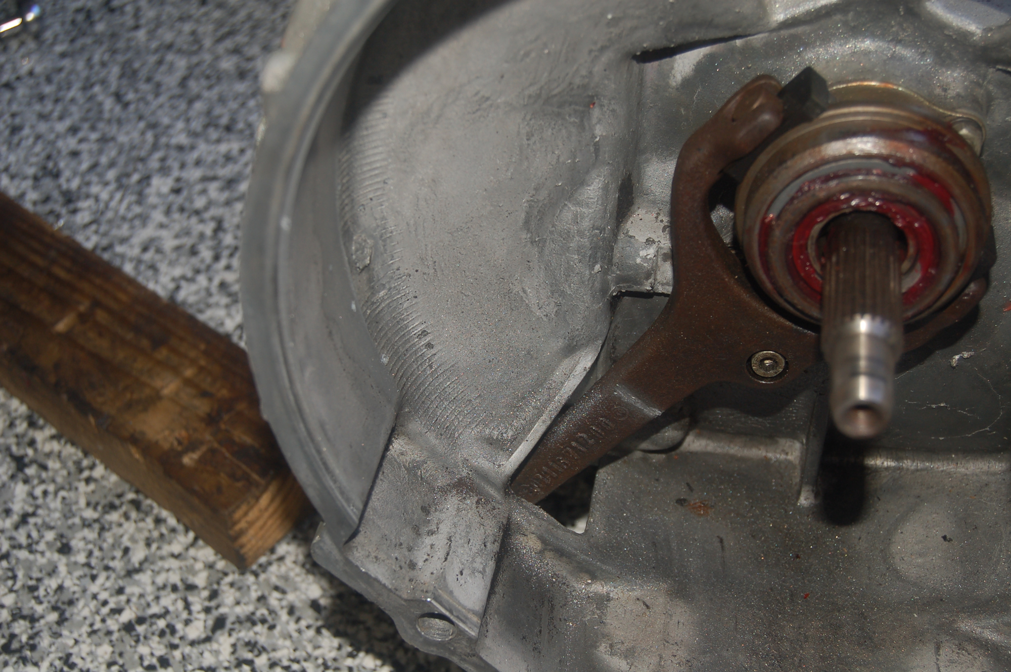

FOUND IT.
The clutch fork (release fork) is riding on the pressure plate.
Question now is WHY???
Pictures show the rubbing clearly.

QUOTE(lsintampa @ Aug 21 2013, 10:56 AM) *
FOUND IT.
That's good.
The fork has to have both a bushing underneath it as well as a retaining "fork." If you remove that allen head screw and consult the diagram in the PET, you'll see what I mean. Ensure that it's assembled correctly.
Also, it's common for people to "shim" the clutch lever ball stud with a washer when material is removed from the flywheel. This returns the original amount of leverage to the lever, but it is possible they shimmed it too much? (IMG:style_emoticons/default/confused24.gif)

QUOTE(ThePaintedMan @ Aug 21 2013, 10:07 AM) *
FOUND IT.
Good find! (IMG:style_emoticons/default/agree.gif) Maybe they shimmed this for the old flywheel. Now it is a new one and doesn't need them.

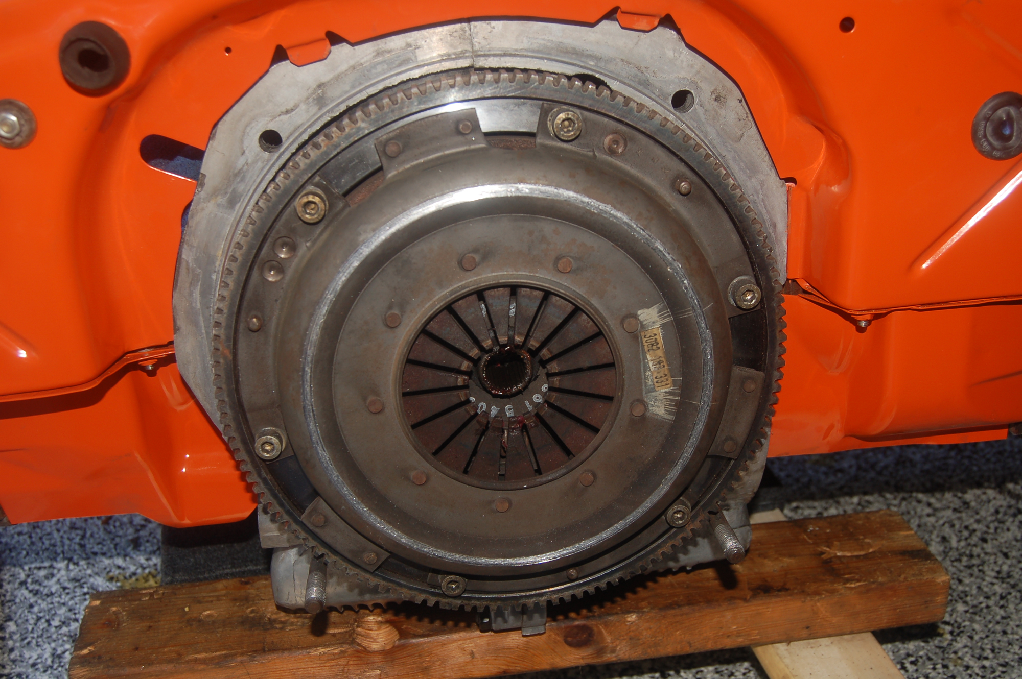

carguy914   Picture shows the clutch is properly installed, th...   Aug 21 2013, 04:44 PM
ThePaintedMan   Picture shows the clutch is properly installed, t...   Aug 21 2013, 06:39 PM
lsintampa   Picture shows the clutch is properly installed, t...   Aug 21 2013, 06:43 PM
