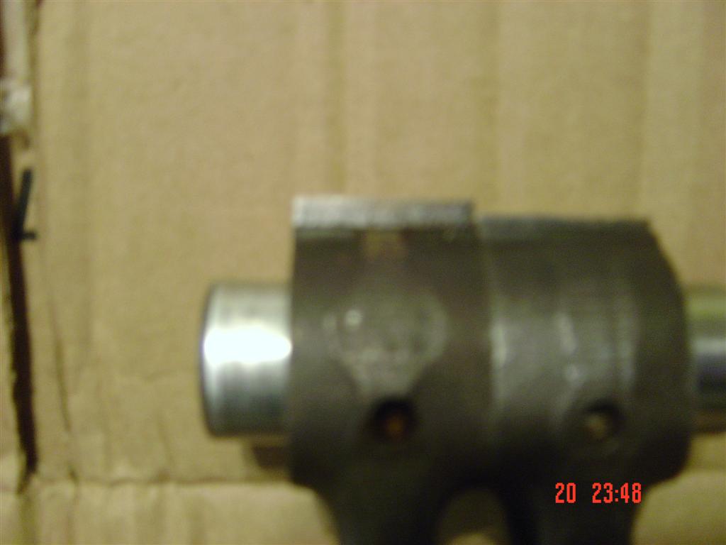

Attached ImageHere is a picture of the rods. #3 is on the right side.
The retangular end looks to be possibly grinded down on #3. Not sure if this was done to lighten/balance the rod.
It appears that they measure the same distance from the center of each hole but I guess I need to have a machine shop possibly check this.

Racer Chris   Could this throw off the balance of the rod and c...   Aug 21 2013, 10:41 AM
LCOX   Here is a picture of the rods. #3 is on the right...   Aug 21 2013, 10:01 AM
stugray   If you are really anal about your balancing: http...   Aug 21 2013, 11:23 AM
