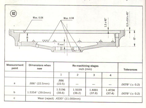

Check the distance from the flywheel friction face to the pressure plate mounting surface (A), should be 22.5 mm (.886") +0.2mm (.0078")Attached Image

John Jentz   Check the distance from the flywheel friction face...   Aug 22 2013, 12:05 PM
lsintampa   Check the distance from the flywheel friction fac...   Aug 22 2013, 12:21 PM
