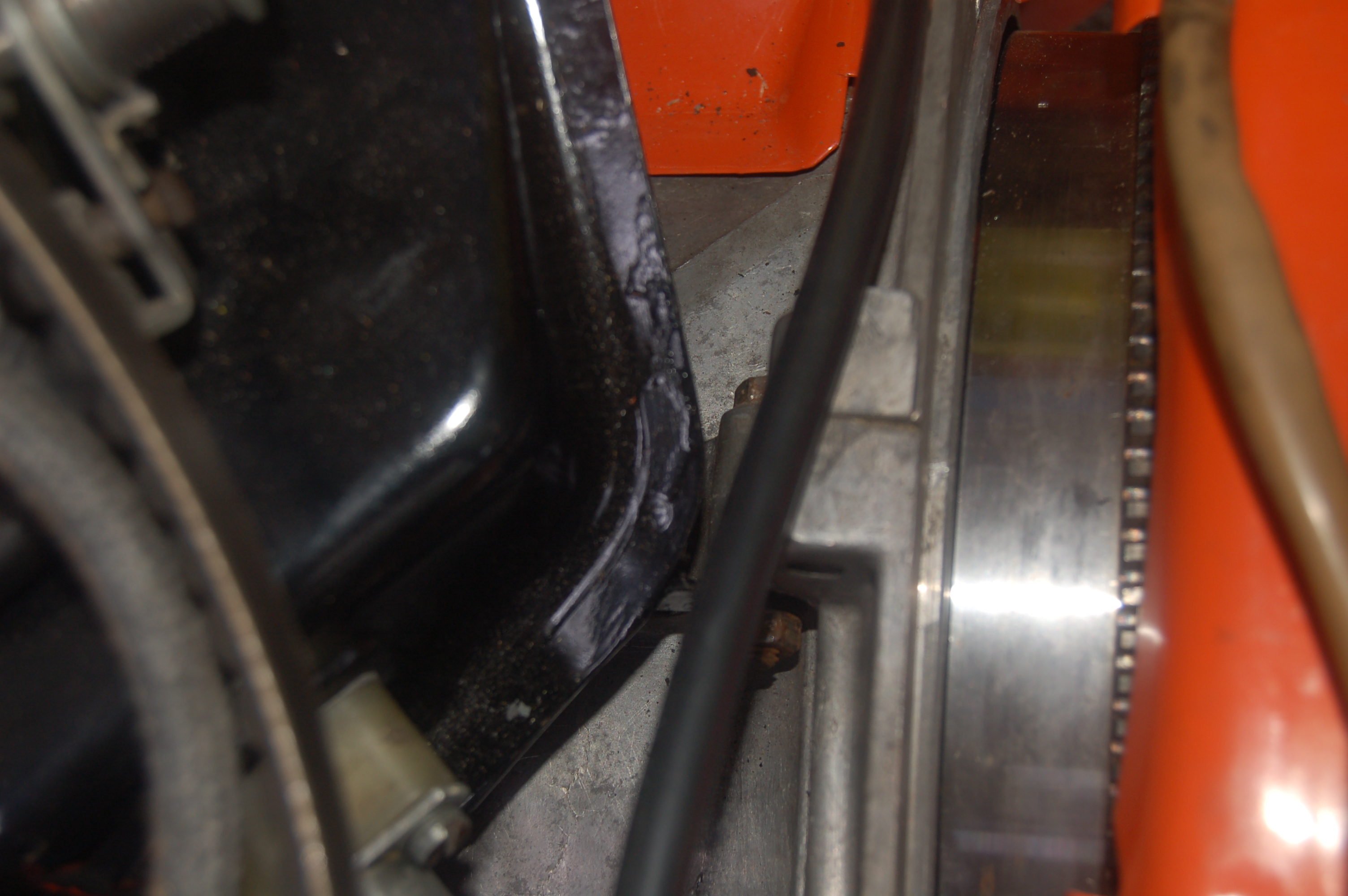

IDK,
My opinion (for what that's worth) is that the flywheel juts too far back into the bell housing away from the rear of the motor.
The measurements from that drawing match up to the rough measurements I'm able to do with the flywheel still mounted.
Look at this picture. The flywheel is actually a tiny bit OUT from the back of the motor's edge. There is room for it to sit down deeper in. Might there be a spacer behind the flywheel... or is that how far out it is supposed to sit?
I may as well remove the thing and see what I see????
