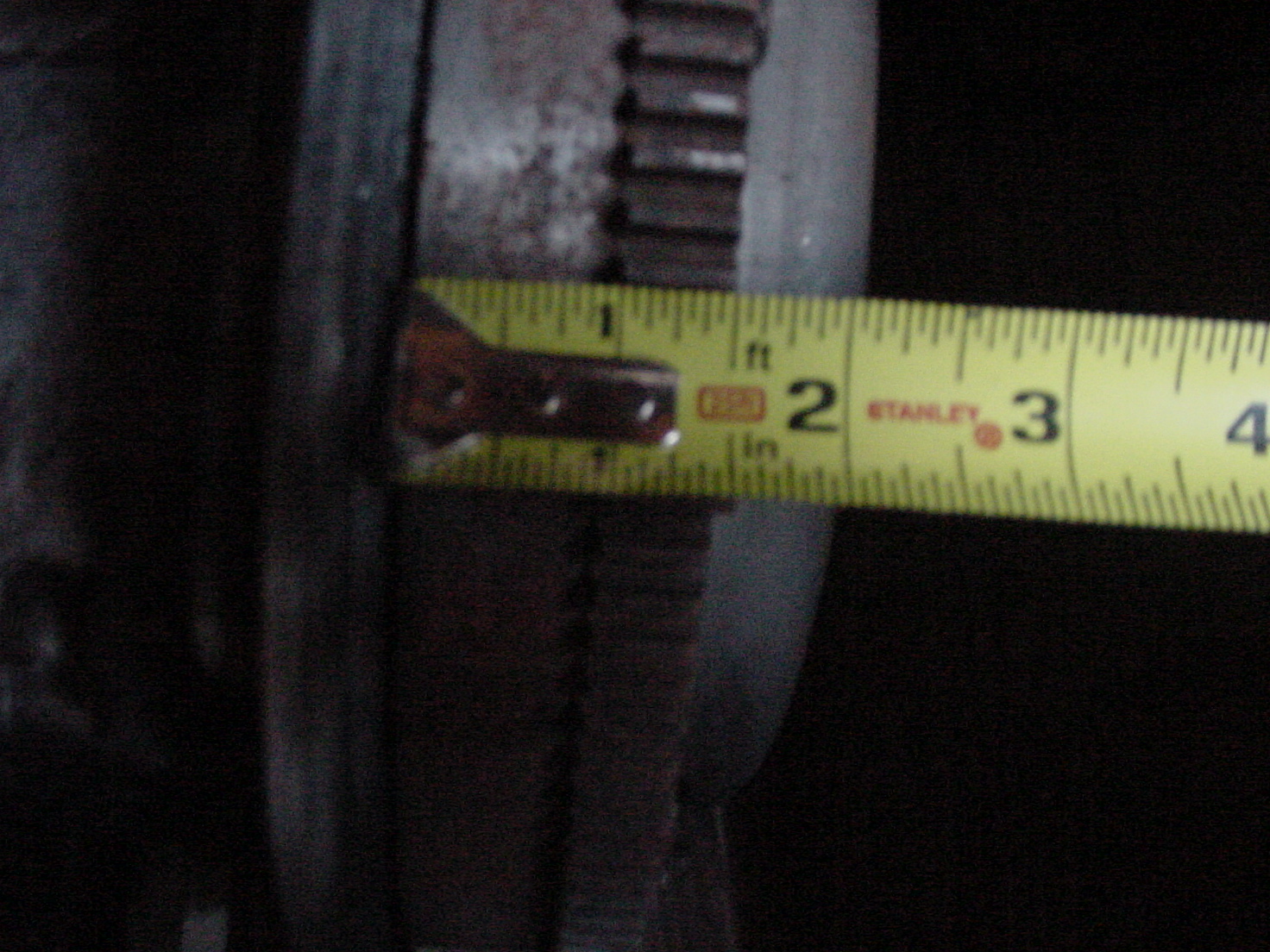

post Aug 22 2013, 01:07 PM
Posts: 22,252
Joined: 2-March 03
From: Orion's Bell. The BELL!
Member No.: 378
this setup worked fine when pulled. 1 1/2" from the rear of the case to the rear side of the fw. the disc 'snout' is 3/8" from the non tob side of the pressure plate fingers.

rhodyguy   this setup worked fine when pulled. 1 1/2" fr...   Aug 22 2013, 01:07 PM
lsintampa   this setup worked fine when pulled. 1 1/2" f...   Aug 22 2013, 01:40 PM
