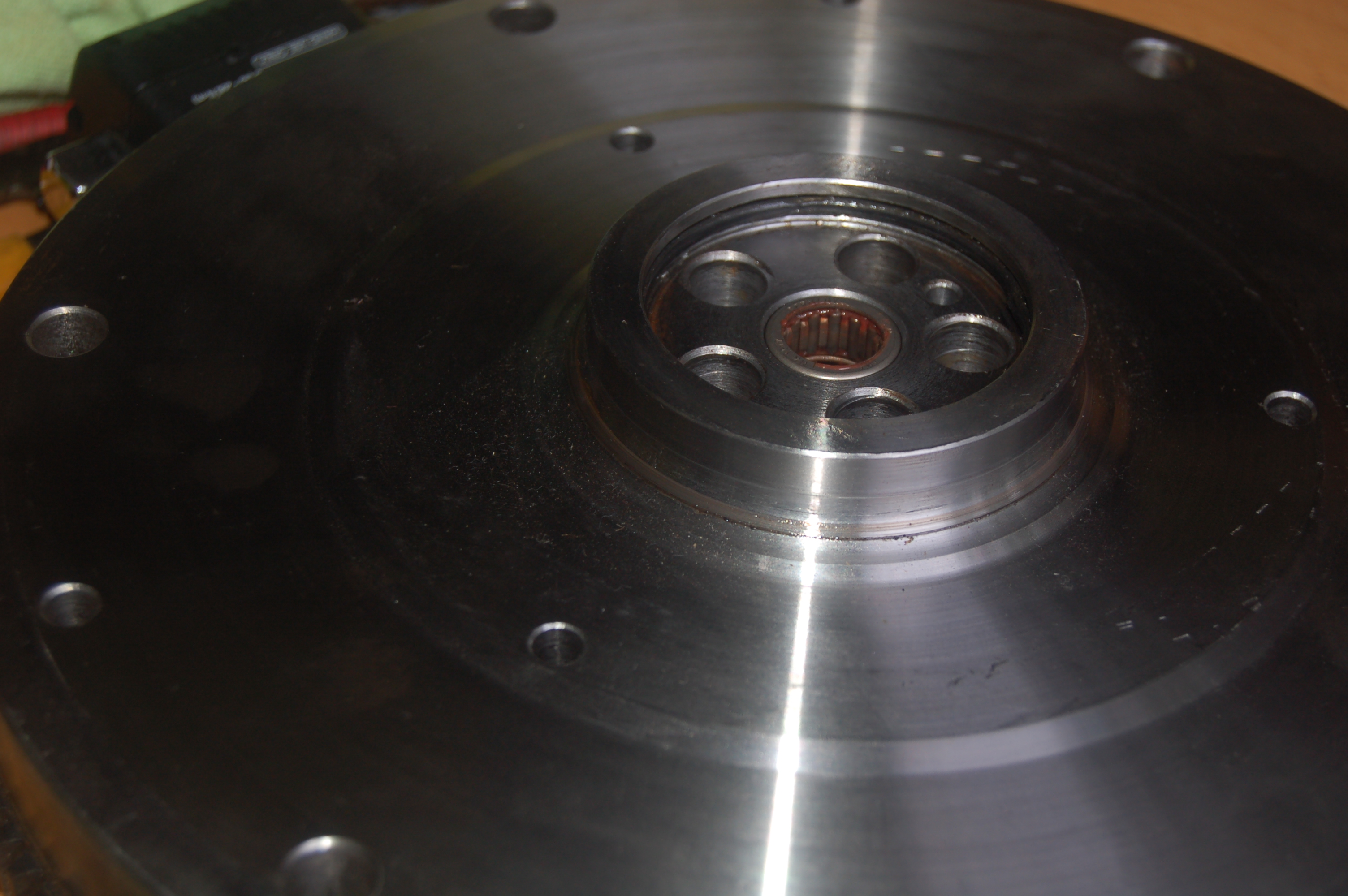

this setup worked fine when pulled. 1 1/2" from the rear of the case to the rear side of the fw. the disc 'snout' is 3/8" from the non tob side of the pressure plate fingers.

QUOTE(rhodyguy @ Aug 22 2013, 03:07 PM) *
Same measurement I get about 1.5".
The pressure plate is about 33MM from the mounting surface to it's highest point.
Flywheel looks to be OK. Measurements that I could take seem to be fine.

John Jentz   Check the distance from the flywheel friction face...   Aug 22 2013, 12:05 PM
lsintampa   Check the distance from the flywheel friction fac...   Aug 22 2013, 12:21 PM
lsintampa   IDK, My opinion (for what that's worth) is t...   Aug 22 2013, 12:38 PM
