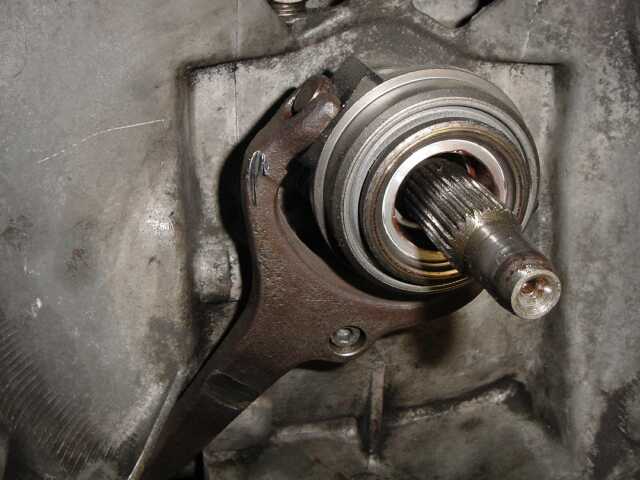

Here's that fork I was talking about.
This poor fellow had a different issue, but do you see the indent on the arm of the fork?
My fork doesn't have that indent and I think maybe it should?????
IDK fellows, I'm just grasping at straws here.

lsintampa   Here's that fork I was talking about. This po...   Aug 22 2013, 02:13 PM
ThePaintedMan   Len, no indent on any of my clutch forks. Is you...   Aug 22 2013, 02:35 PM
