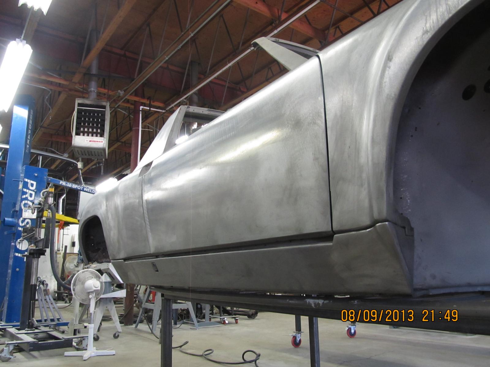

couple more angles.....
(IMG:http://www.914world.com/bbs2/uploads_offsite/images.thesamba.com-14902-1377325399.1.jpg)
(IMG:http://www.914world.com/bbs2/uploads_offsite/images.thesamba.com-14902-1377325399.2.jpg)
like 356's?

The Metal Surgeon   couple more angles..... http://www.914world.com/...   Aug 24 2013, 12:23 AM
GeorgeRud   Truly beautiful work! Thanks for sharing all ...   Aug 24 2013, 03:01 PM
Nine_14   state of the art in bodywork .... needs a good pai...   Aug 24 2013, 03:35 PM
