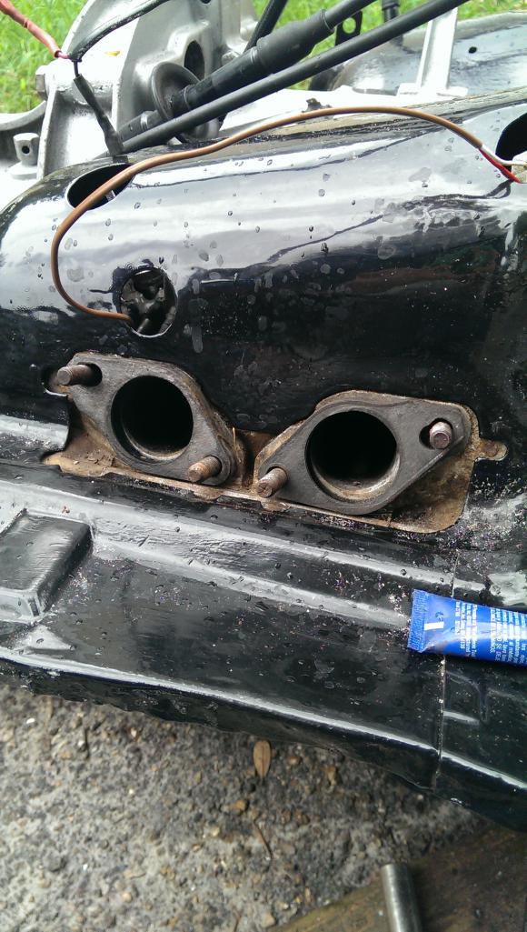

Hey guys,
Just finishing up the prep on getting my spare motor back in the car. Came across something a little "fishy". So, I swapped over just about everything that was on my 1.7, and this engine is *supposed* to be a 1.8. Everything fits just fine, except for the intake manifolds and gaskets. There are 4 intake manifold studs, but the outer studs are about 3/8 inches further apart than on the 1.8. So much so, that the new 1.7/1.8 phenolic spacers that I have do not fit over the studs. I noticed that the previous owner had cut the spacers in half to make two separate pieces, for each intake port. They still didn't fit quite right though, and part of the spacer protrudes into the intake hole/bore.
I'm wondering if these are some kind of other Type 4 head, perhaps from a bus? Pictures to follow in a moment...

Looking at the pic, it looks like they're not original 3-stud ... they wouldn't have that separation between the ports.

type47   How about the alignment with the holes on the inta...   Aug 25 2013, 01:47 PM
ThePaintedMan   The intake manifolds line up fine, from what I can...   Aug 25 2013, 01:52 PM

skeates   Was the mis-match the same on both heads? Could be...   Aug 26 2013, 01:10 PM
euro911   Was the mis-match the same on both heads? Could be...   Aug 26 2013, 01:31 PM
Cap'n Krusty   I have seen ONLY one 4 bolt intake manifold bolt p...   Aug 26 2013, 01:21 PM
euro911   I have seen ONLY one 4 bolt intake manifold bolt p...   Aug 26 2013, 01:33 PM
Cap'n Krusty   Yup. "Race track" looking exhaust ports...   Aug 26 2013, 01:55 PM
ThePaintedMan   Yeah I knew about the square exhaust ports on the ...   Aug 26 2013, 02:04 PM
r_towle   Could be the 2.0 liter heads that someone removed ...   Aug 26 2013, 08:11 PM
euro911   Looking at the pic, it looks like they're not ...   Aug 26 2013, 11:38 PM
ThePaintedMan   Yeah I had considered that they were 2.0 heads tha...   Aug 27 2013, 06:11 AM
r_towle   could have been re-drilled to the 2.0 liter outer ...   Aug 27 2013, 01:13 PM
