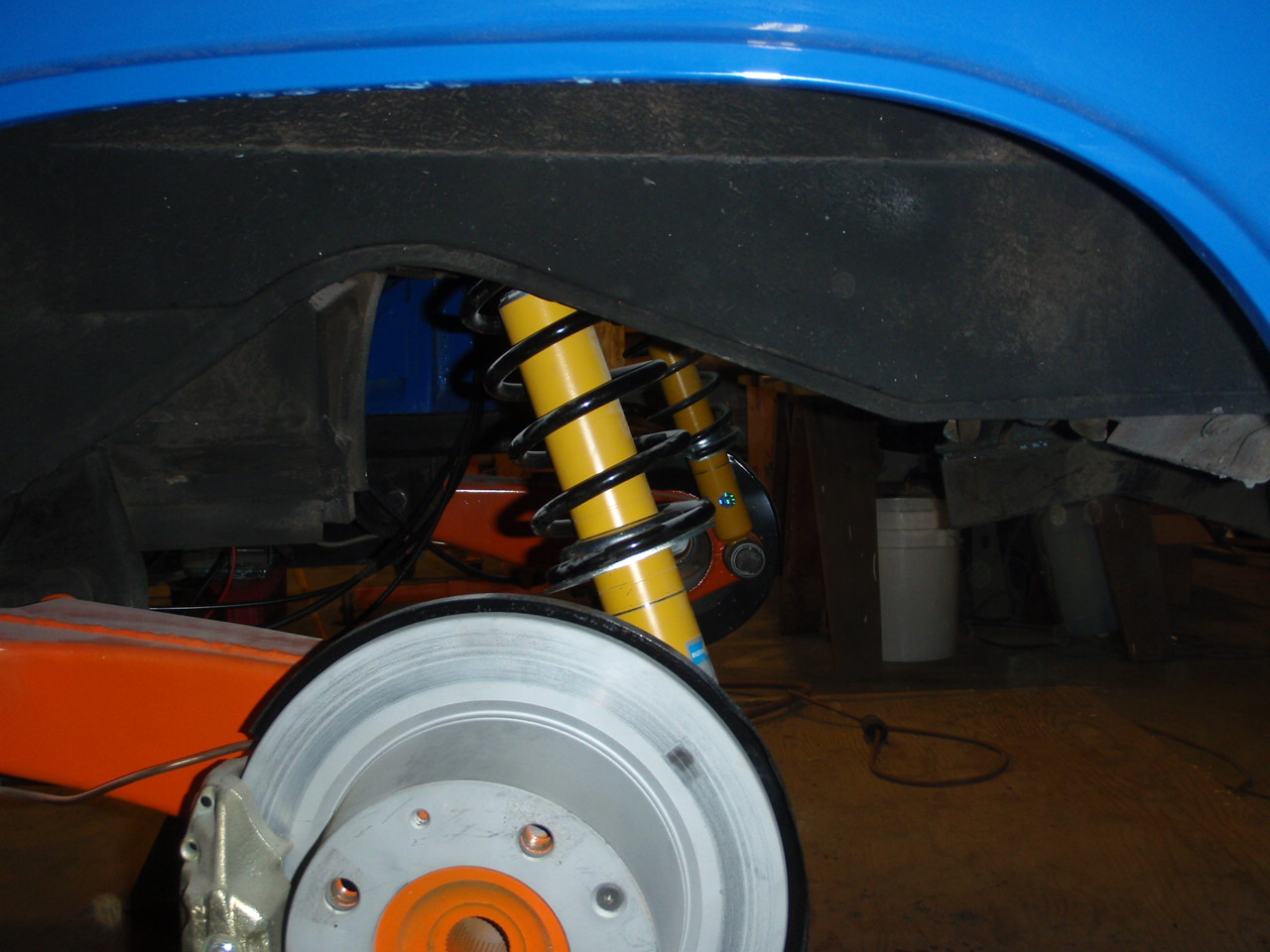

Installing new Bilstein shocks with 140 lb springs. took off stock springs with Koni's with a spring compressor. I didn't really need the spring compressors for the Bilstein's and now they slip off the bottom cradle. The Bilstein cradle is flat where the Koni's is more formed, like the top piece from the car.
What am I doing wrong here (note I installed them backwards to see it there was a difference). which reminds me...which end is up the small coils or the larger?
(IMG:http://www.914world.com/bbs2/uploads_offsite/i139.photobucket.com-11790-1377472264.1.jpg)
(IMG:http://www.914world.com/bbs2/uploads_offsite/i139.photobucket.com-11790-1377472264.2.jpg)

jimkelly   that silver plate is upside down - I think   Aug 25 2013, 05:19 PM
messix   that silver plate is upside down - I think Yup l...   Aug 25 2013, 05:24 PM
76-914   Here is your exact setup. :agree: Once it's d...   Aug 25 2013, 05:41 PM

Type 47   Thanks guys :headbang: I will filp the plate ove...   Aug 25 2013, 06:12 PM
messix   there should be a spilt ring [a wire that almost g...   Aug 25 2013, 07:55 PM
wndsnd   Your telling me these are upside down? Sorry ...   Aug 25 2013, 08:44 PM
messix   Your telling me these are upside down? Sorry...   Aug 25 2013, 08:47 PM

zambezi   Another reason the silver perch should be the othe...   Aug 25 2013, 08:52 PM
r_towle   Upside down guys. The clip won't car, but the...   Aug 25 2013, 08:56 PM

wndsnd   OK I flipped the plates. Where would you rec...   Aug 26 2013, 08:43 AM
zambezi   The lower the clip the lower the ride height. I s...   Aug 26 2013, 08:58 AM
76-914   It varies. This just establishes your ride height....   Aug 26 2013, 10:58 AM
wndsnd   It varies. This just establishes your ride height...   Aug 26 2013, 11:06 AM
wndsnd   :bump: Rich T, Racer Chris, Anyone? Where wou...   Aug 27 2013, 06:38 AM
Racer Chris   Start at the 4th groove from the bottom John. You ...   Aug 27 2013, 07:18 AM
wndsnd   Start at the 4th groove from the bottom John. You...   Aug 27 2013, 07:42 AM
r_towle   bottom :) I like it low. Honestly, 2-4th from the...   Aug 27 2013, 01:10 PM
wndsnd   bottom :) I like it low. Honestly, 2-4th from th...   Aug 27 2013, 01:52 PM
wndsnd   Finished. Thanks everyone. Really sorry Type 47 ...   Aug 27 2013, 03:18 PM
Type 47   Finished. Thanks everyone. Really sorry Type 47...   Aug 27 2013, 05:53 PM
r_towle   Finished. Thanks everyone. Really sorry Type 47...   Aug 27 2013, 09:07 PM
wndsnd   Finished. Thanks everyone. Really sorry Type 4...   Aug 28 2013, 06:19 AM
r_towle   [quote name='r_towle' post='1916319' date='Aug 27...   Aug 28 2013, 06:49 AM
