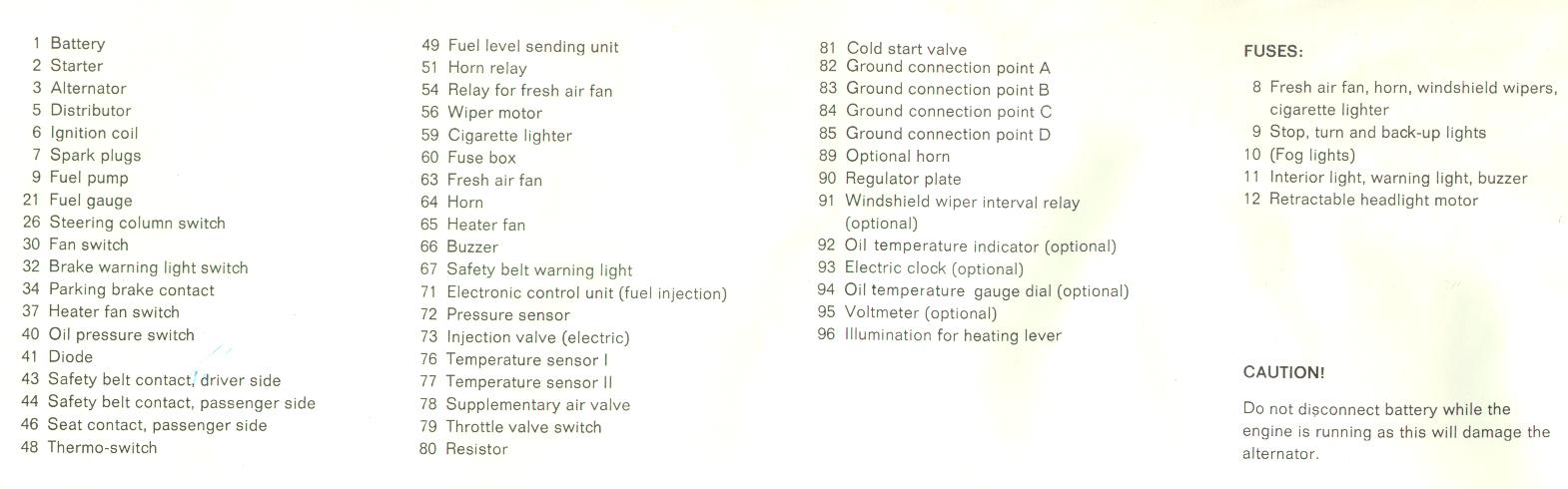

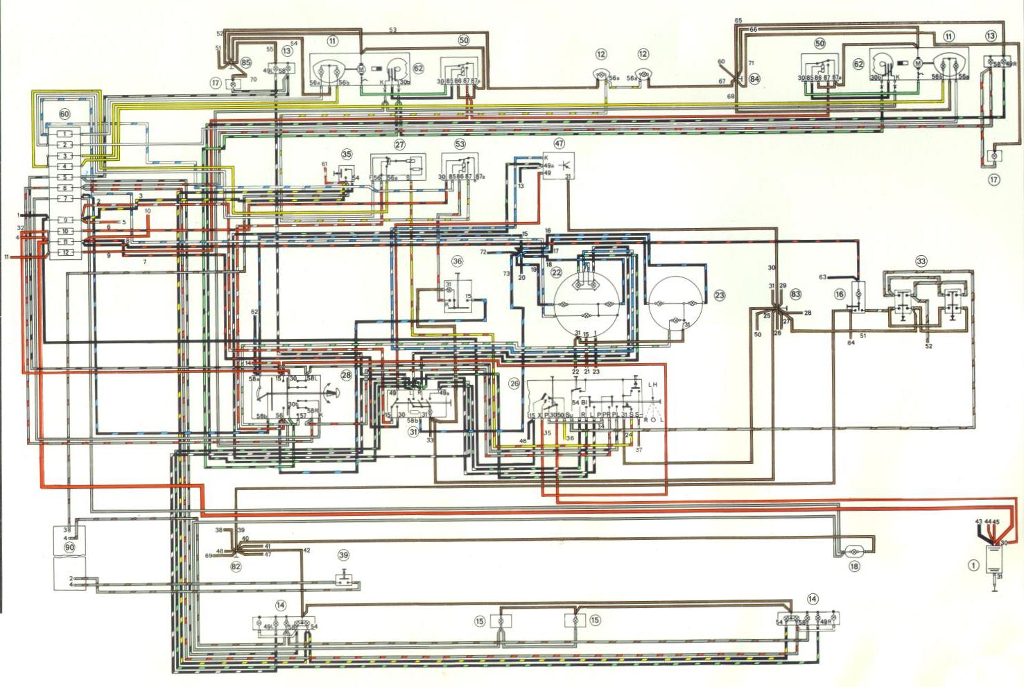

That diagram is for 1974 car... (IMG:style_emoticons/default/wink.gif)
But it should still be somewhat useful if not entirely accurate. The wire colors/stripes should indicate what each goes to per the tabel at the bottom.
The 1973 car has that diode in the circuits for the combo brake warning (master cyl)/ebrake light. The factory schematics will tell you where each wire goes - I think Pelican has them online.

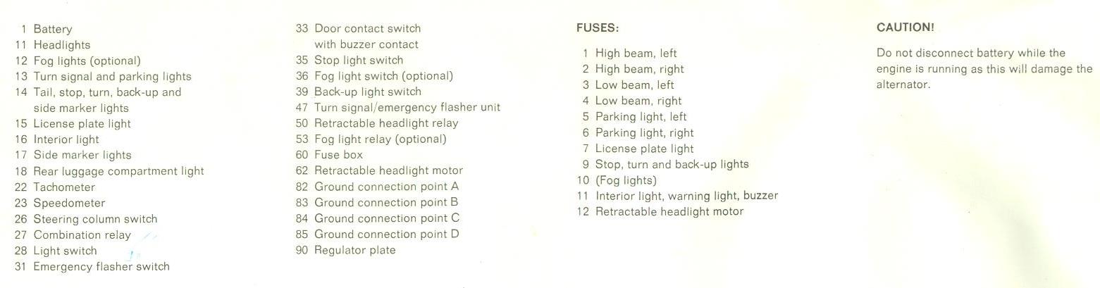

Jeff,
Is it the one enclosed? On the legend I'm not exactly sure of what I'm seeing :-(
The "combo", are they referring to 41 Diode on chart C, legend D?
I see the speedo and tach on Chart A, Legend B but nothing that looks like the combo gauge :-/
Cornfused.
