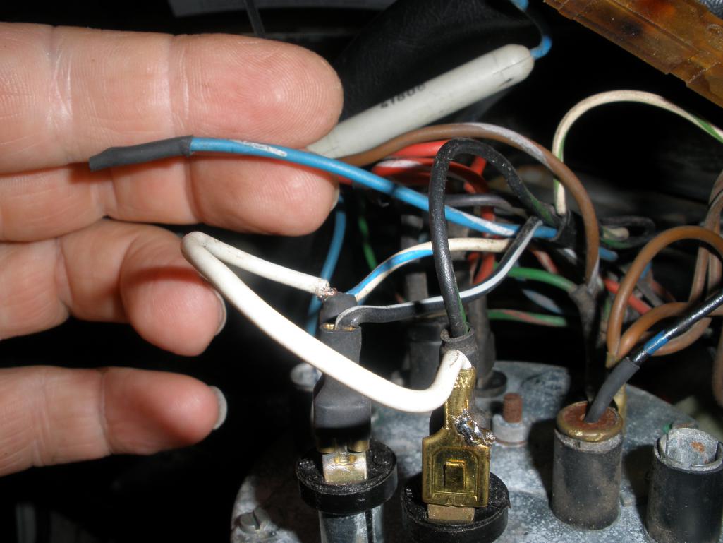

Imagine my dismay when today I decided to open the dash (I was trouble shooting a fuel gauge not working-easy fix, PO had cut the wires at the tank for some reason), discovering a huge amount of loose wires. The PO had installed a completly different tach so I'm hoping alot of these wires (11) had a purpose for being disconnected. Vain hope most likely...
I did notice the brake warning light stays on all the time...and of course nothing else works (except the fuel gauge that I just hooked back up). The car is a v-8 converted teener so alot of stuff may be disconnected for that reason as well. The real problem is that I'm VERY color blind. I can read a schematic reasonably well if I know what color wires I'm looking at on the car, which brings us to the reason for this post! Could someone help me identify the loose wires I've numbered in the enclosed photograph? What color corresponds to the numbered wires? With that data I should be able to figure out what was supposed to go where and assimilate if it was disconnected for purpose. Wiring and color blindness can be a serious challenge, so any help is appreciated :-) David Oh and btw, if you click on the image and then click again you'll get a very close view |

Ferg 1. Red/white stripe
2. Green/red stripe
3. Brow... Aug 27 2013, 03:57 PM

Dave_Darling Note that the wires numbered 9, 10, and 11 are add... Aug 28 2013, 08:04 AM

Note that the wires numbered 9, 10, and 11 are ad... Aug 28 2013, 08:29 AM
Jeff Bowlsby Actually...
The factory used different striping p... Aug 28 2013, 10:09 AM

bulitt David- I crawled up on the lift to look at mine-
... Aug 29 2013, 02:47 PM

bulitt Got that David?
Number 4 hooks to both lights
6 to... Aug 29 2013, 04:48 PM

bulitt yes Aug 29 2013, 06:13 PM
HalfMoon :Qarl:
AWESOME!
It worked and now my former b... Aug 29 2013, 06:50 PM

bulitt Yes, the one you are holding should go to the turn... Aug 31 2013, 06:21 AM![]() ![]() |
