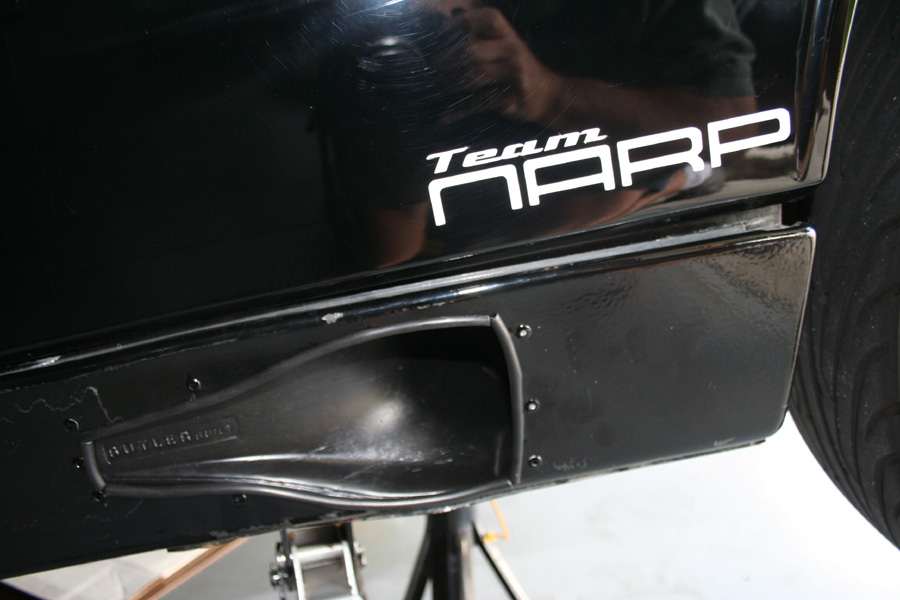

The engine in my car is about the same as yours but just short of 2.2 (76 crank and 96 pistons). I use a sandwich plate. Not the best thing but most certainly the easiest. I would certainly agree that -12 hose would be the best way to go and that is what I use. Steel braid is a bit of over kill but it is also what I use but I use it for the same reason I have vented brake rotors all the way around because it looks cool. (IMG:style_emoticons/default/biggrin.gif) My external cooler is under the rear trunk and worked well until I installed a really low air dam in the front and not much air goes under the car. I installed a scoop in the left rocker panel and ducted the air to the cooler with a 3 inch duct. Works great. Having said that, I will probably start installing a front oil cooler after the RCC. Why? Because it looks cool (IMG:style_emoticons/default/av-943.gif) and I always need a project for this car and I'm sure it will have a six in it someday... Really soon... I think... Maybe. (IMG:style_emoticons/default/laugh.gif)

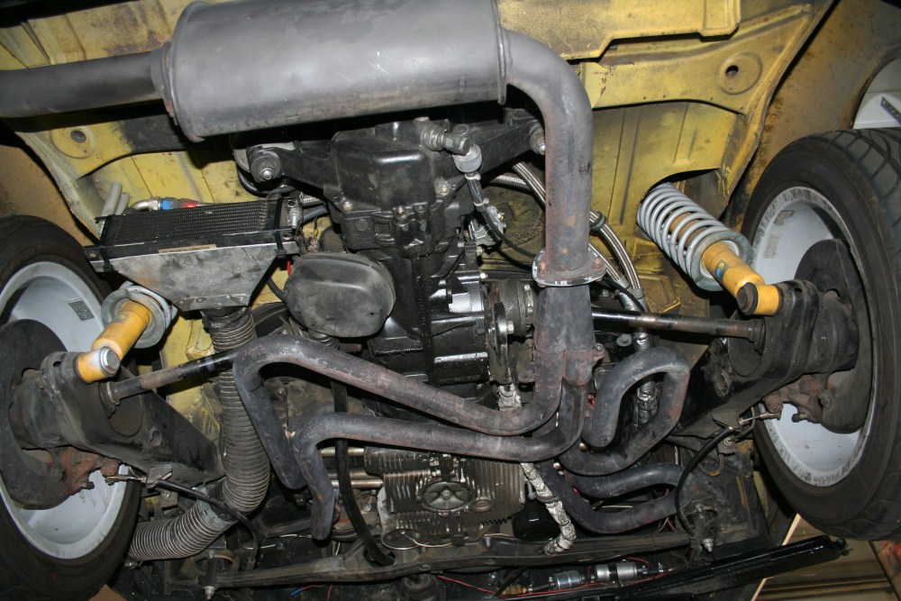

type47   When I bought my orange car, it came with this Ear...   Sep 1 2013, 09:01 AM

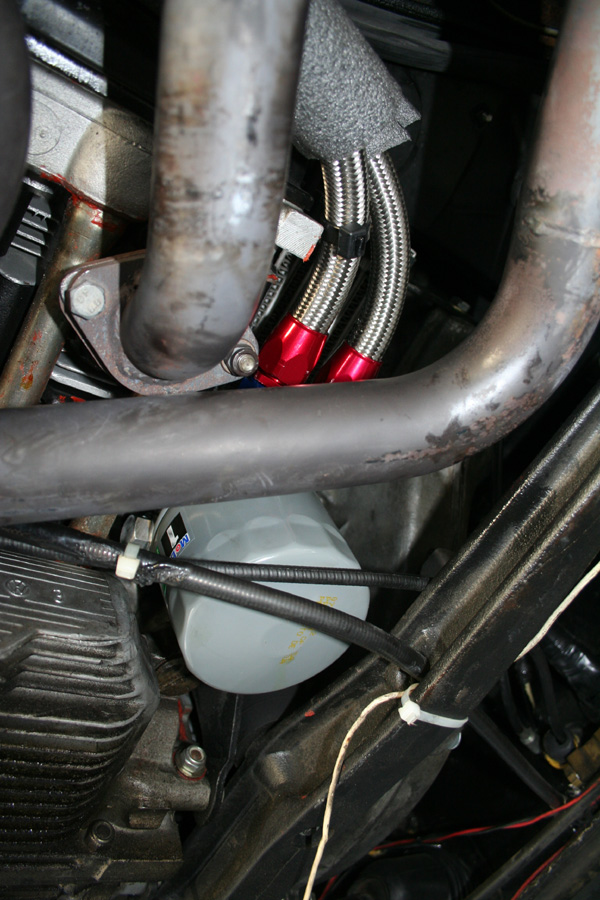

Elliot Cannon   The oil cooler lines on the Yellow Zonker ran unde...   Sep 1 2013, 11:58 PM
brant   My black car is also routed close to the yellow si...   Sep 2 2013, 05:21 AM
