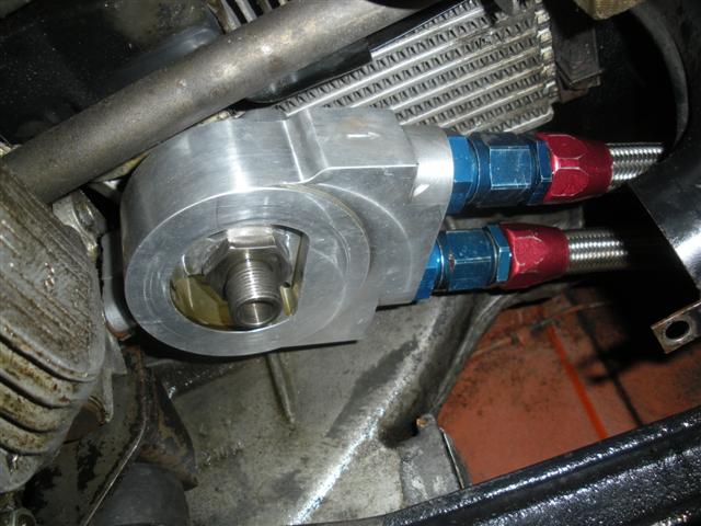

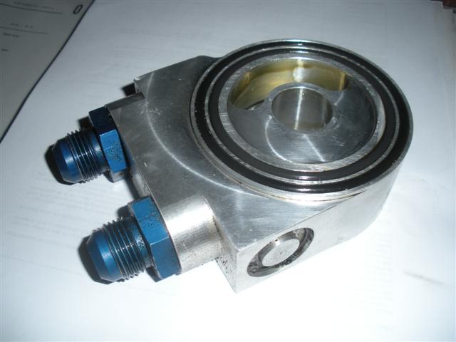

When I bought my orange car, it came with this Earl's sandwich adapter with thermostat.

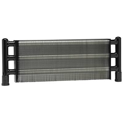

It is plumbed to a front mounted oil cooler like this one
I was still getting high oil temps so I was told I should/needed to block off the oil pressure relief valve in the intermediate flange because the oil was not circulating to the oil cooler so I installed this

stock, maybe that's the problem? I was told the block off was needed because the oil was escaping through the oil pressure relief ball and spring in the intermediate flange and not going through the cooler

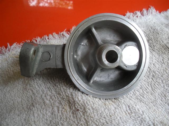

Also, I took off the intermediate plate off and plugged the bypass valve by by drilling, tapping a hole on the top of the plate and ran bolt through which blocks the bypass ball from moving. I locked it in place with jb weld.
