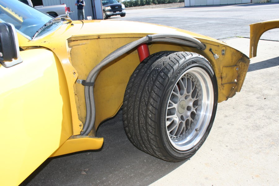

The oil cooler lines on the Yellow Zonker ran under the rocker panels. After exiting the rocker panels, it follows the inside of the fender, then back into the front trunk to the Mazda RX 7 cooler. I worked great while I owned the car. I sold the car a few years ago and hope it still does. (IMG:style_emoticons/default/biggrin.gif)

Elliot Cannon   The oil cooler lines on the Yellow Zonker ran unde...   Sep 1 2013, 11:58 PM
brant   My black car is also routed close to the yellow si...   Sep 2 2013, 05:21 AM
