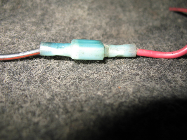

jimkelly   well, finally got a battery today. hooked it up, ...   Oct 10 2013, 01:41 PM
jimkelly   hooked my fuel to gas but she backfires and pops. ...   Oct 11 2013, 07:24 AM
