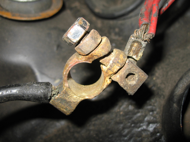

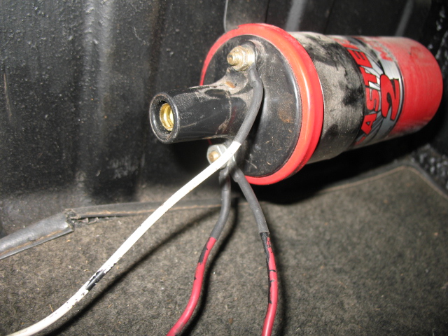

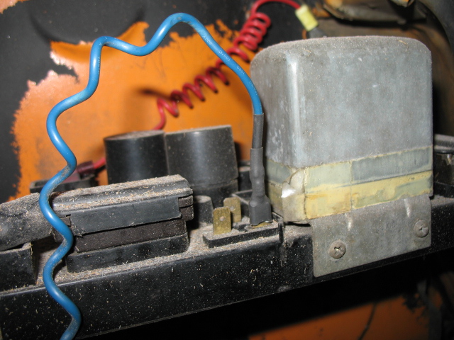

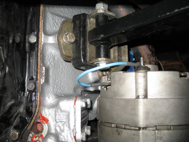

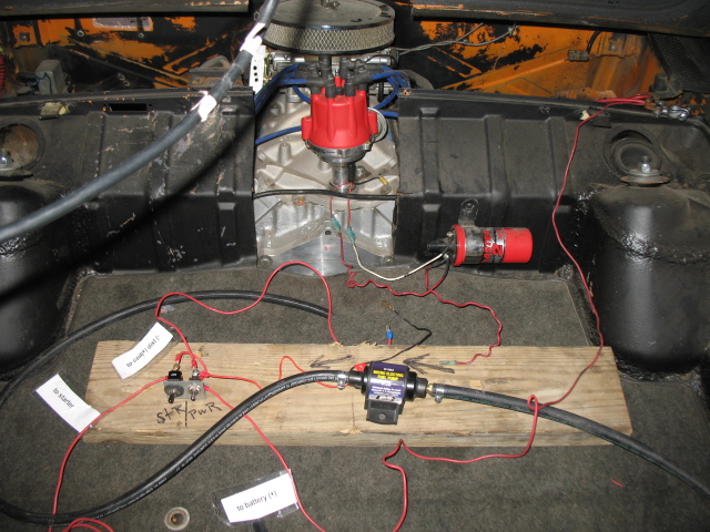

wiring my v8
and tell me what I have wrong or missing.
my bad for never labeling the wires (IMG:style_emoticons/default/headbang.gif)
distributor is msd 8360
but you guys are smart (IMG:style_emoticons/default/smoke.gif)
and yes - I better connect that oil guage line or I will have a mess on my hands.

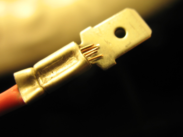

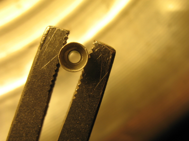

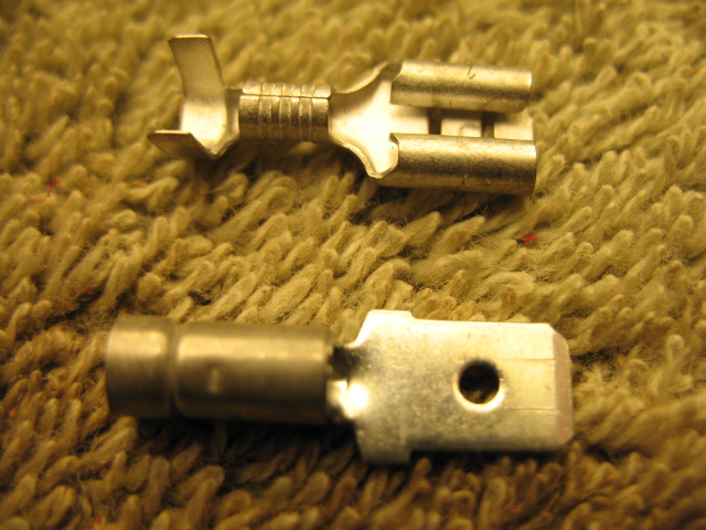

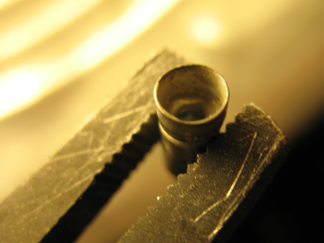

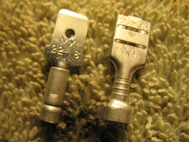

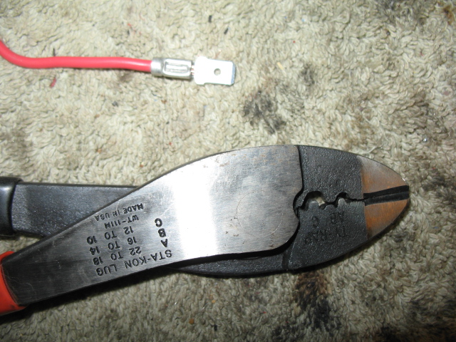

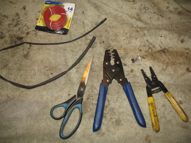

finally going to put my crimper and heat shrink to good use.
though I am not liking that the male double crimp connector has a different DOUBLE CRIMP portion than the female.
in fact, it seems to me, that the napa tool does not work on this male connector and despite mcmaster carr selling them as double crimp, I don't feel they are truly double crimp, as they don't really provide as decent of stress relief as the female's as they don't crimp well onto the wire insulator.
it seems to me, that my other crimp tool is better for these male's. see pics.
and some connector clean up.
preparing to start engine.

jimkelly   hooked my fuel to gas but she backfires and pops. ...   Oct 11 2013, 07:24 AM
wndsrfr   hooked my fuel to gas but she backfires and pops....   Oct 11 2013, 07:53 AM
