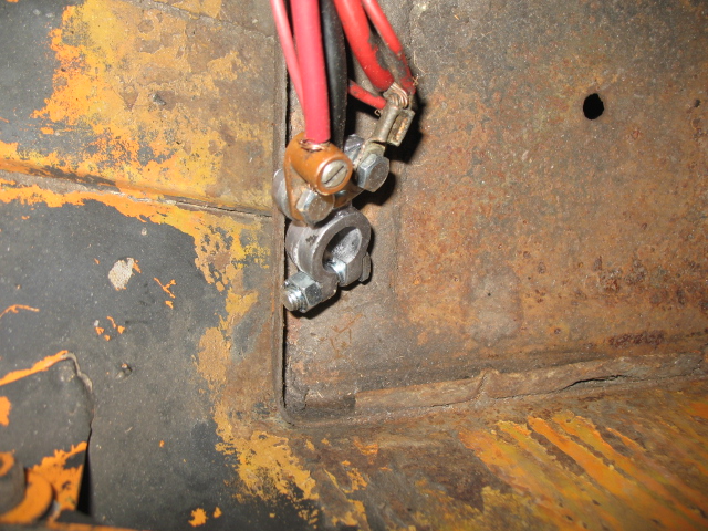

wiring my v8
and tell me what I have wrong or missing.
my bad for never labeling the wires (IMG:style_emoticons/default/headbang.gif)
distributor is msd 8360
but you guys are smart (IMG:style_emoticons/default/smoke.gif)

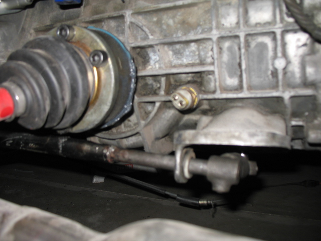

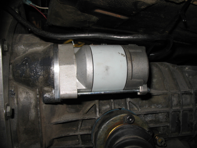

starter, shift linkage, gear oil, coolant fill neck, installed
Monday I swap out the early for late soft front passenger side brake line and add fluid and bleed.
for a whole this morning, I thought I had the firing sequence all buggered up, but after looking at it over and over again, i think it is ok.
waiting on ebay to deliver my CHROME dip stick and tube, I am sure engine is empty.

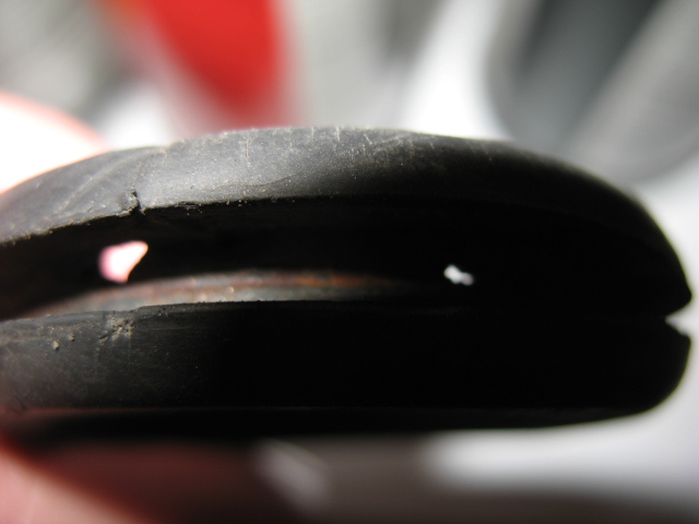

getting the correct grommets for front trunk is hell!!! one hose is 1.5 ID and the other is 1.7 ID, the bigger one is more of a challenge and the thicker the better as to have more rubber between hose and sheet metal, as mu old thinner grommets wore thru.

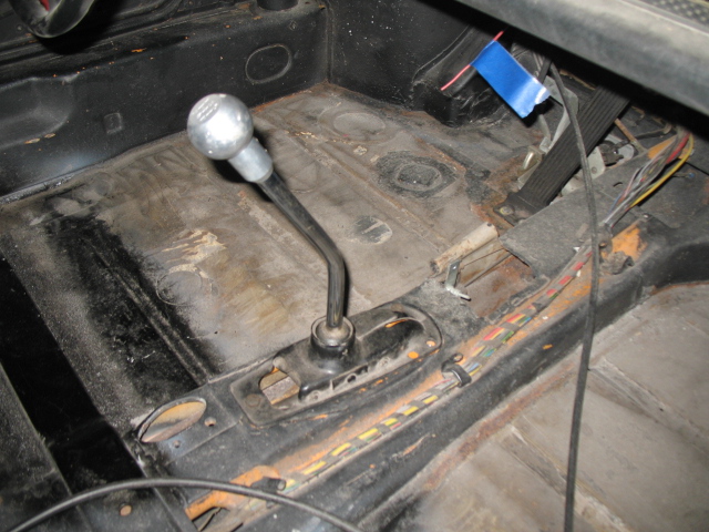

stock engine bay shift bar is 39.25" and renegade suggests adding 1.5" to this. the modified bar I have is 40" and should be fine but I will try to weld up a new straight one. as before I was using a custom engine bar, not renegade's..
