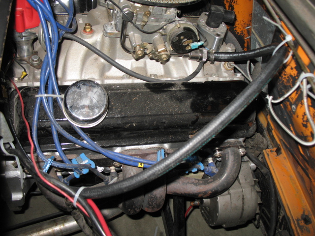

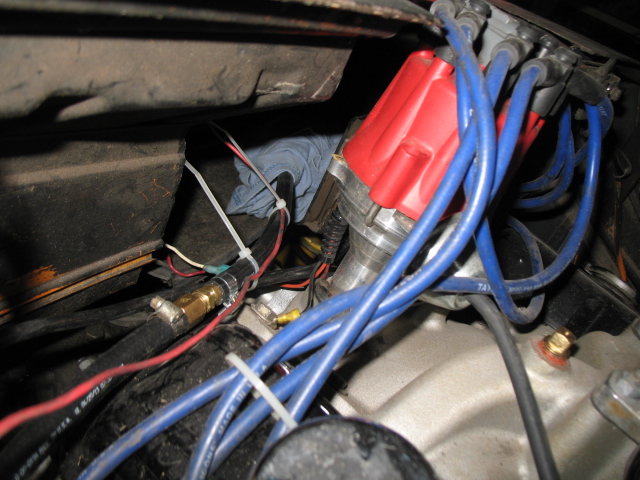

wiring my v8
and tell me what I have wrong or missing.
my bad for never labeling the wires (IMG:style_emoticons/default/headbang.gif)
distributor is msd 8360
but you guys are smart (IMG:style_emoticons/default/smoke.gif)
and yes - I better connect that oil guage line or I will have a mess on my hands.

3d914   IIRC the yellow wire goes to the positive side of ...   Sep 16 2013, 01:01 PM

Spoke   Page 5: Red wire from harness is 12V power to coil...   Sep 16 2013, 02:13 PM
jimkelly   spoke I am pretty sure my ignition switch was par...   Sep 16 2013, 02:30 PM

jimkelly   spoke image 6 - the blue wire loops around and co...   Sep 16 2013, 07:31 PM
Spoke   spoke image 6 - the blue wire loops around and c...   Sep 17 2013, 06:49 AM
dwillouby   I dont use the relay board. You need a switched 12...   Sep 17 2013, 06:42 AM

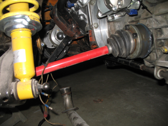

kg6dxn   Your lower spring perch is upside down... :( http...   Sep 22 2013, 07:17 PM
jimkelly   thanks for that!!! jim   Sep 22 2013, 07:45 PM

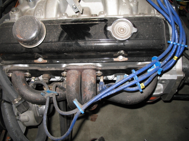

jimkelly   hooked my fuel to gas but she backfires and pops. ...   Oct 11 2013, 07:24 AM
wndsrfr   hooked my fuel to gas but she backfires and pops....   Oct 11 2013, 07:53 AM
DBCooper   or is this round mark at top of flywheel the tdc ...   Oct 11 2013, 09:51 AM
jimkelly   firing order seems to be 18436572 but finding tdc ...   Oct 11 2013, 08:22 AM
jimkelly   thanks guys, you've given me good guidance. dt...   Oct 11 2013, 10:36 AM

DBCooper   It looks like the number 1 wire goes up to the lef...   Oct 11 2013, 04:42 PM
jimkelly   all the images i found have cylinders 1-2 3-4 5-6...   Oct 11 2013, 05:24 PM
jimkelly   db I could kiss you, right on the mouth. GREAT eye...   Oct 11 2013, 06:09 PM
