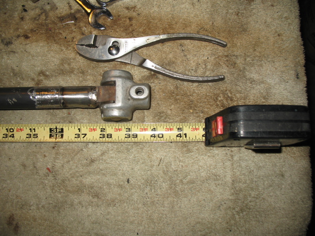

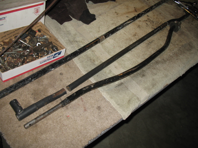

just goofing around, since I already have a bar that fits.

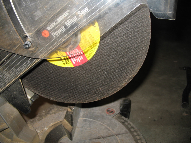

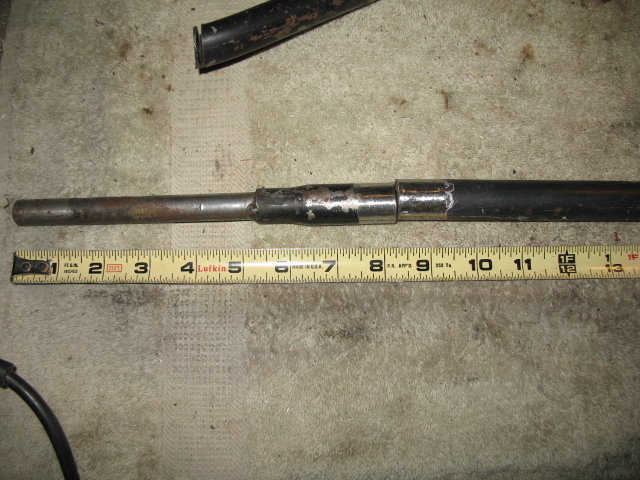

I put a cut off wheel in my mitre box and cut some tailshift linkage and side shift linkage, both engine bay rods.
correction: cutting both bars just before the bends will give me a modded bar almost exactly 39.75" long tip to tip, 1" too short - i will ad 1", to get to 40.75". stock is 39.25".
note: it is odd that the side shift engine bay bar is neither totally straight, nor are the holes for the conical screws perfectly lined up. I will be ignoring this, since both are cocked ever so slightly.

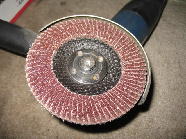

also, I have to say, a flap disc kicks ass. grinds better than a grinding wheel in many cases. never expected that.

zambezi   yes they grind better and produce less heat. Easi...   Sep 21 2013, 12:31 PM
jimkelly   engine bay shift rod done : ) 40.75" it is ...   Sep 21 2013, 01:15 PM
