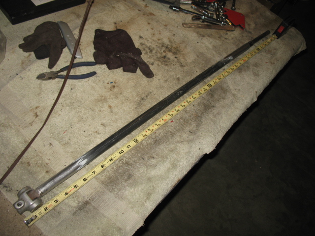

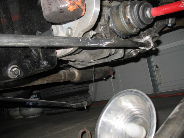

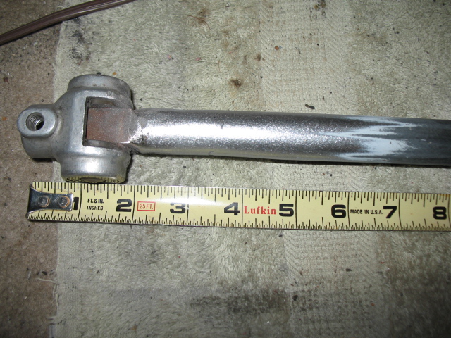

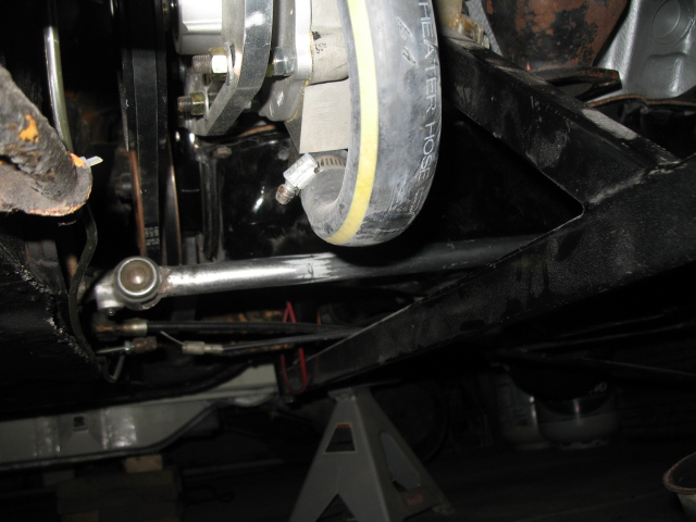

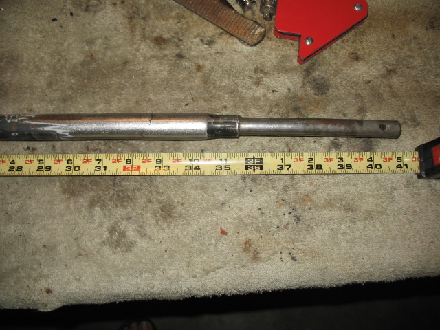

engine bay shift rod done : )
40.75"
it is pretty darn straight, but I think the tang that goes into the console is tweaked - so I will tweak it back to straight a tiny bit.

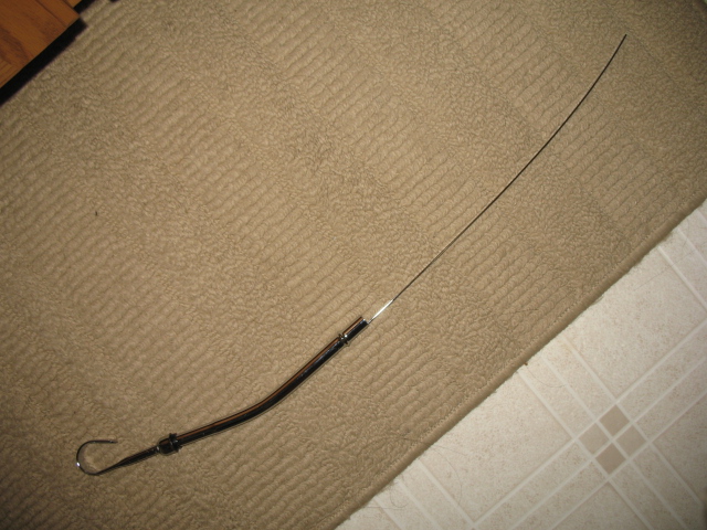

and got my dip stick in the mail - made in korea of all places - and of course it won't seat fully, about 1/4 inch shy.
I found that after grinding an area, taking a DA sander to the area, makes it real nice.
ok - she is in - and she is pretty ; )
