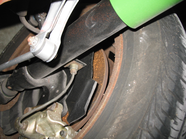

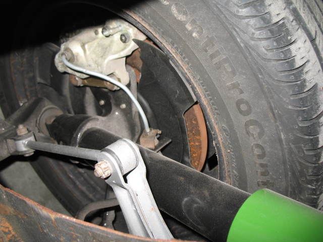

> making some progress on my sbc 307 V8 car, -- rear sway bar back in

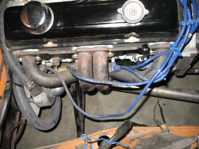

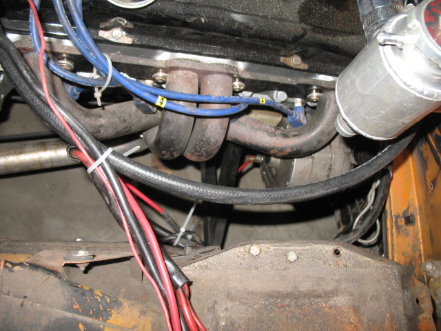

wiring my v8
and tell me what I have wrong or missing.
my bad for never labeling the wires (IMG:style_emoticons/default/headbang.gif)
distributor is msd 8360
but you guys are smart (IMG:style_emoticons/default/smoke.gif)
and yes - I better connect that oil guage line or I will have a mess on my hands.

3d914   IIRC the yellow wire goes to the positive side of ...   Sep 16 2013, 01:01 PM
jimkelly   thank you - I am editing my collage as we go. jim   Sep 16 2013, 01:05 PM

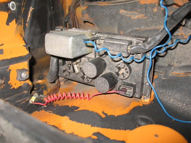

Spoke   Page 5: Red wire from harness is 12V power to coil...   Sep 16 2013, 02:13 PM
jimkelly   spoke I am pretty sure my ignition switch was par...   Sep 16 2013, 02:30 PM

jimkelly   spoke image 6 - the blue wire loops around and co...   Sep 16 2013, 07:31 PM
Spoke   spoke image 6 - the blue wire loops around and c...   Sep 17 2013, 06:49 AM
dwillouby   I dont use the relay board. You need a switched 12...   Sep 17 2013, 06:42 AM
jimkelly   I was thinking that since it seems to be the only ...   Sep 17 2013, 07:03 AM
jimkelly   finally going to put my crimper and heat shrink to...   Sep 17 2013, 08:01 AM

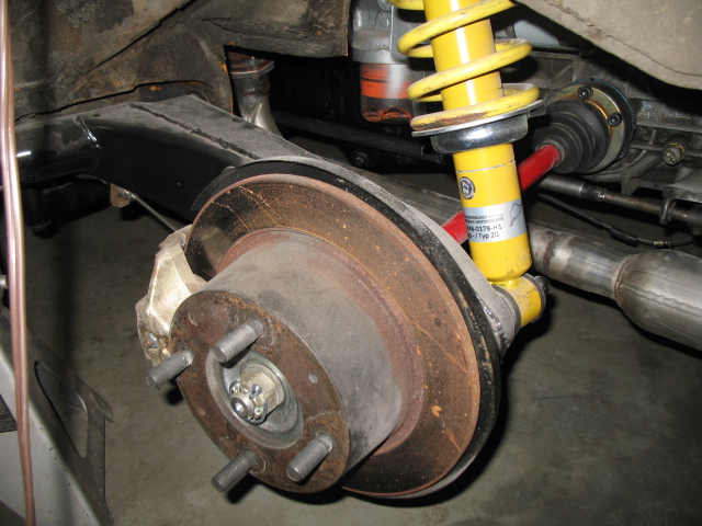

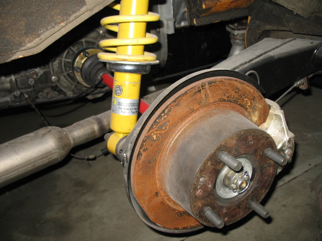

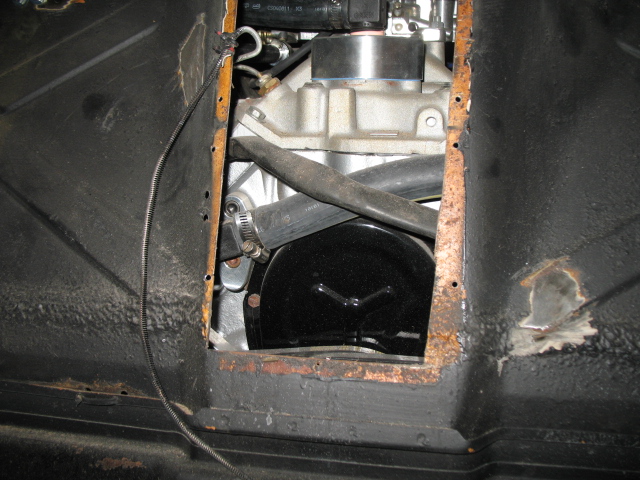

kg6dxn   Your lower spring perch is upside down... :( http...   Sep 22 2013, 07:17 PM
jimkelly   thanks for that!!! jim   Sep 22 2013, 07:45 PM

76-914   Is that a "red" ground wire? <_<   Sep 23 2013, 03:04 PM
jimkelly   from the relay board to the body? yes. I will ch...   Sep 25 2013, 09:27 AM

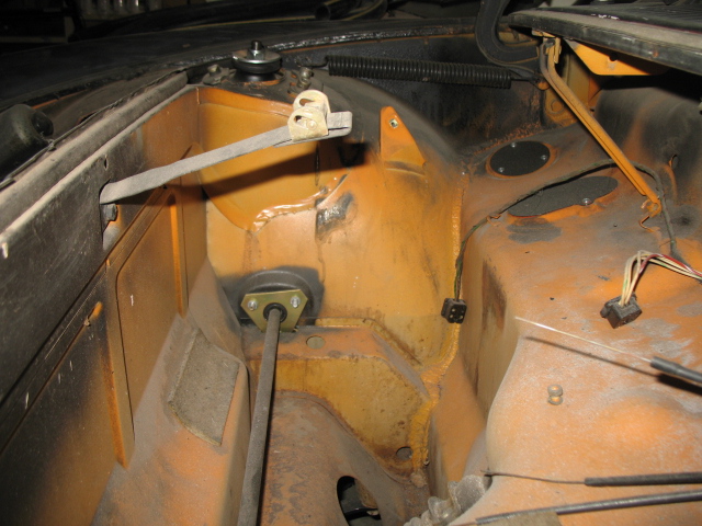

jimkelly   well, my car had a big gap, at top, between the dr...   Oct 7 2013, 11:41 AM
JRust   Yeah the aluminum 90% was a good move. I didn...   Oct 7 2013, 08:11 PM
jimkelly   well two issues. I need to either come up with a ...   Oct 9 2013, 01:12 PM
JRust   The big washer with the groove goes on the bottom ...   Oct 9 2013, 03:17 PM
jimkelly   I have been searching and have yet to find a pic o...   Oct 9 2013, 04:57 PM
JRust   I have been searching and have yet to find a pic ...   Oct 10 2013, 07:20 AM
