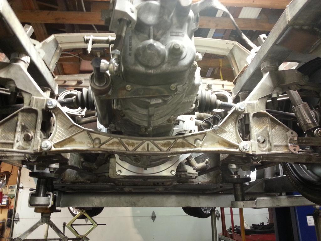

Here is a view of the rear suspension, I'm now looking over every nut and bolt.
(IMG:http://www.914world.com/bbs2/uploads_offsite/i60.photobucket.com-3782-1379907273.1.jpg)

drive-ability   The picture shows how the 996 suspension bolts i...   Sep 13 2013, 11:03 PM
bulitt   I think JRust is parting with a steel flared LS1 p...   Sep 14 2013, 03:02 AM
