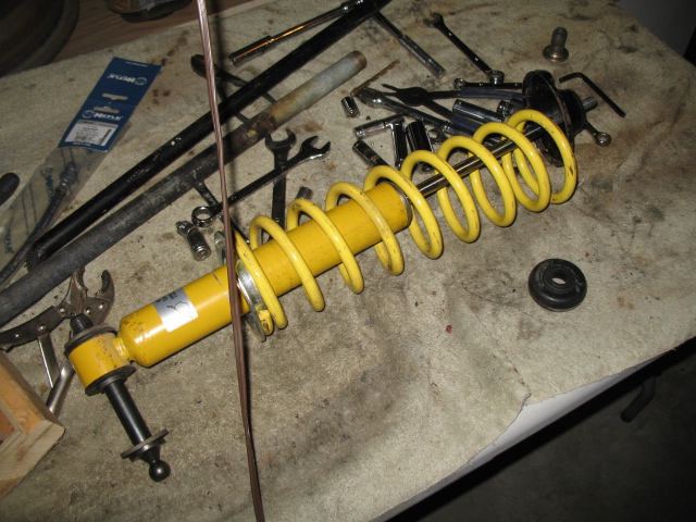

jimkelly   just goofing around, since I already have a bar th...   Sep 21 2013, 08:34 AM
zambezi   yes they grind better and produce less heat. Easi...   Sep 21 2013, 12:31 PM
jimkelly   engine bay shift rod done : ) 40.75" it is ...   Sep 21 2013, 01:15 PM

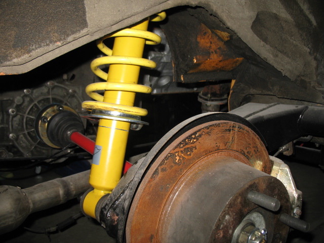

kg6dxn   Your lower spring perch is upside down... :( http...   Sep 22 2013, 07:17 PM
jimkelly   thanks for that!!! jim   Sep 22 2013, 07:45 PM
jimkelly   don't be an idiot like me. anyway, one flippe...   Sep 23 2013, 07:41 AM

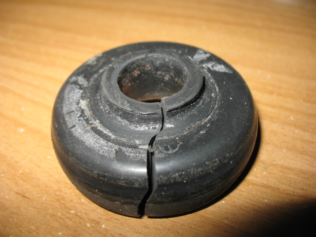

jimkelly   well, my car had a big gap, at top, between the dr...   Oct 7 2013, 11:41 AM
JRust   Yeah the aluminum 90% was a good move. I didn...   Oct 7 2013, 08:11 PM
jimkelly   well two issues. I need to either come up with a ...   Oct 9 2013, 01:12 PM
JRust   The big washer with the groove goes on the bottom ...   Oct 9 2013, 03:17 PM
jimkelly   I have been searching and have yet to find a pic o...   Oct 9 2013, 04:57 PM
JRust   I have been searching and have yet to find a pic ...   Oct 10 2013, 07:20 AM
