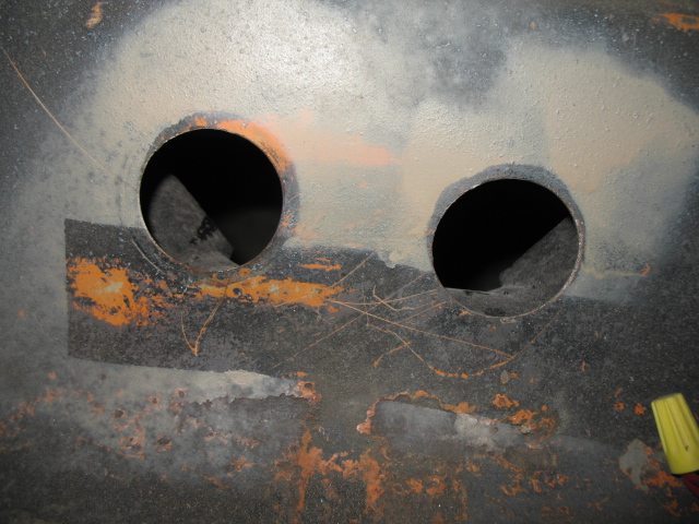

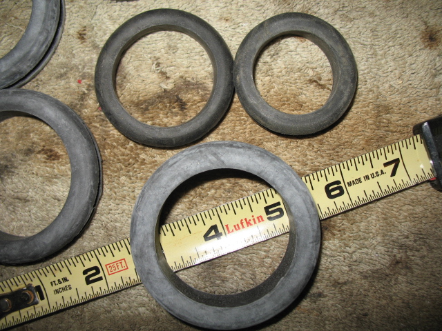

side note: as for the water lines. the exactly correct grommets are a bitcvh to find, so I bought a few of these 2" ID grommets (ebay item # - 261171010853) on ebay cheap, and they will allow me to add some rubber around my hoses to give them even better protection. because my original, properly sized grommets wore thru, and I want to avoid any chance of my hoses getting damaged from contact with sheet metal.
pic shows my orig grommets used and how much sheet metal I need to grind away in order to install the 2" ID ones I just got. need to get a rasp bit.
hoses are 1.4" OD and 1.7" OD.
