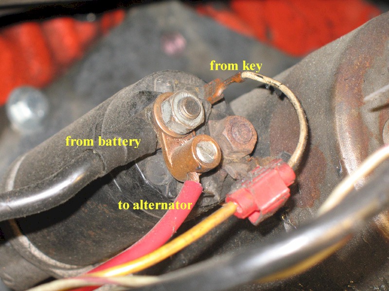

wiring my v8
and tell me what I have wrong or missing.
my bad for never labeling the wires (IMG:style_emoticons/default/headbang.gif)
distributor is msd 8360
but you guys are smart (IMG:style_emoticons/default/smoke.gif)
and yes - I better connect that oil guage line or I will have a mess on my hands.

also - before, I had the pos from alt running to pos on starter.
I guess it can be routed this way or directly to pos on battery?

jimkelly   from the relay board to the body? yes. I will ch...   Sep 25 2013, 09:27 AM
jimkelly   also - before, I had the pos from alt running to p...   Sep 25 2013, 09:35 AM
kg6dxn   also - before, I had the pos from alt running to ...   Sep 25 2013, 09:01 PM
