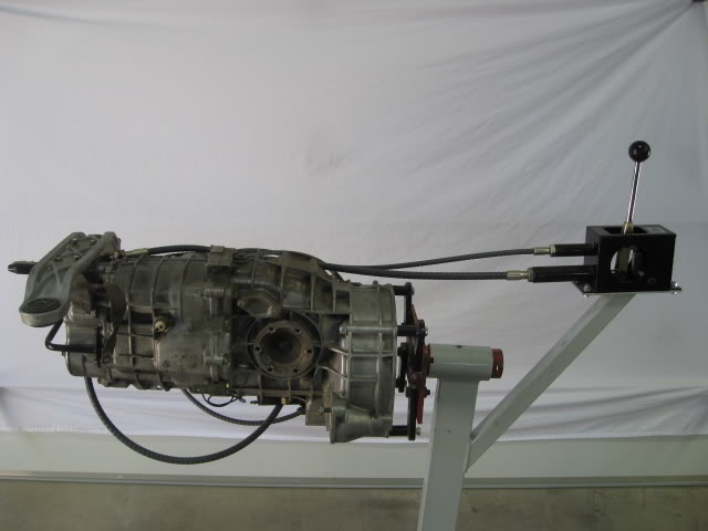

I have decided to remove the single bar shifter and go with a cable unit. I've seen a unit sold by a few vendors and they all look the same as to one sold by Cableshif.com.
Has anyone used any of there shifters ? BTW, they need to hire a photo guy the product is the shifters not the transmissions !!!!
