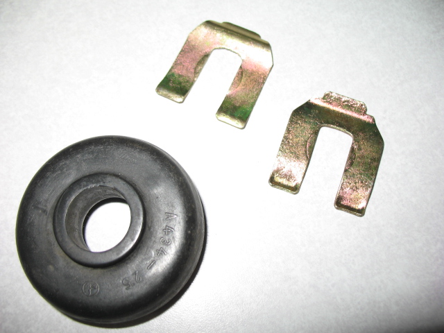

jimkelly   well, my car had a big gap, at top, between the dr...   Oct 7 2013, 11:41 AM
JRust   Yeah the aluminum 90% was a good move. I didn...   Oct 7 2013, 08:11 PM
jimkelly   well two issues. I need to either come up with a ...   Oct 9 2013, 01:12 PM
JRust   The big washer with the groove goes on the bottom ...   Oct 9 2013, 03:17 PM
jimkelly   I have been searching and have yet to find a pic o...   Oct 9 2013, 04:57 PM
JRust   I have been searching and have yet to find a pic ...   Oct 10 2013, 07:20 AM
