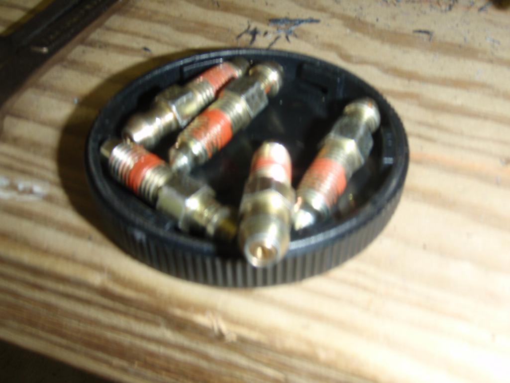

I am trying to bleed my bone dry brake system with a MOTIVE pressure system and a mix of long tube, but since they say you can't use SPEED BLEEDERS with MOTIVE, I want to make sure I am not chasing my tail.
I did bleed each corners twice so far and have some small amount of peddle, maybe 25% or so of normal.
the picture below is a new bleeder and one I pulled out of my jack standed car.

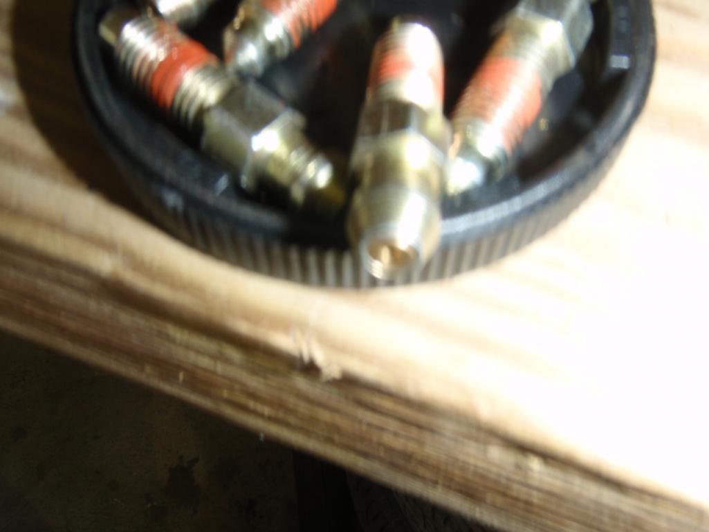

These are speed bleeders Jim,
I took them out cause I couldn't get them to work.
John
Can't get the blur out but you can see the end fitting.
