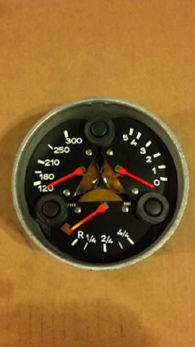

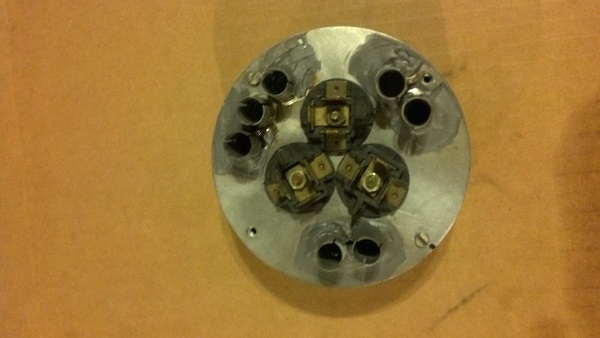

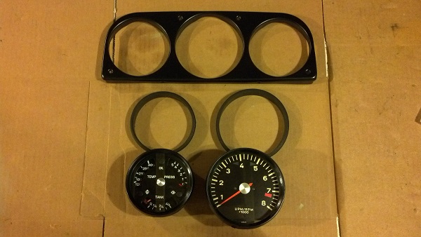

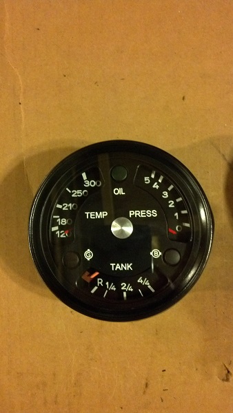

I finally got my gauge kit installation done this morning.
Took some time to install the kit (about 6 hours) but it wasn't too bad.
I just had to work slow so not to mess things up.
If I had to do it again I would pay John to do it.
You need two gauges to make one kit work.
A late 914 fuel gauge and a 911 oil temp/press gauge is needed.
I also opted for the rotated #'s plates.
Then just follow John's instructions for the install.
I soldered the bulb holders, then reinforced them with JB Weld also.
Over all I'm very happy with the gauge. Here's a few pics.
