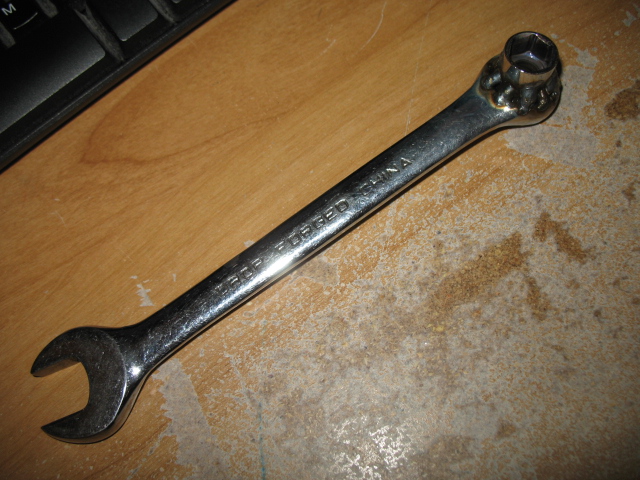

I made this tool from 17mm wrench and 13mm socket.
