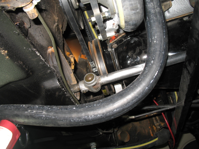

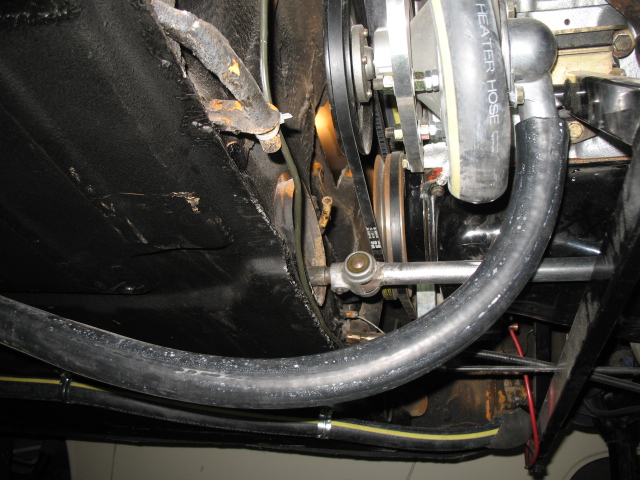

well, not sure I like the relatively short 90 degree bend of the large hose from under car to water pump, a curved tube of aluminum would be real nice here.

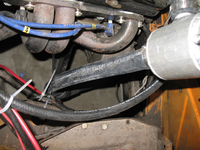

also, what could I put on the smaller hose that will reside only 4-5 inches from exhaust header?

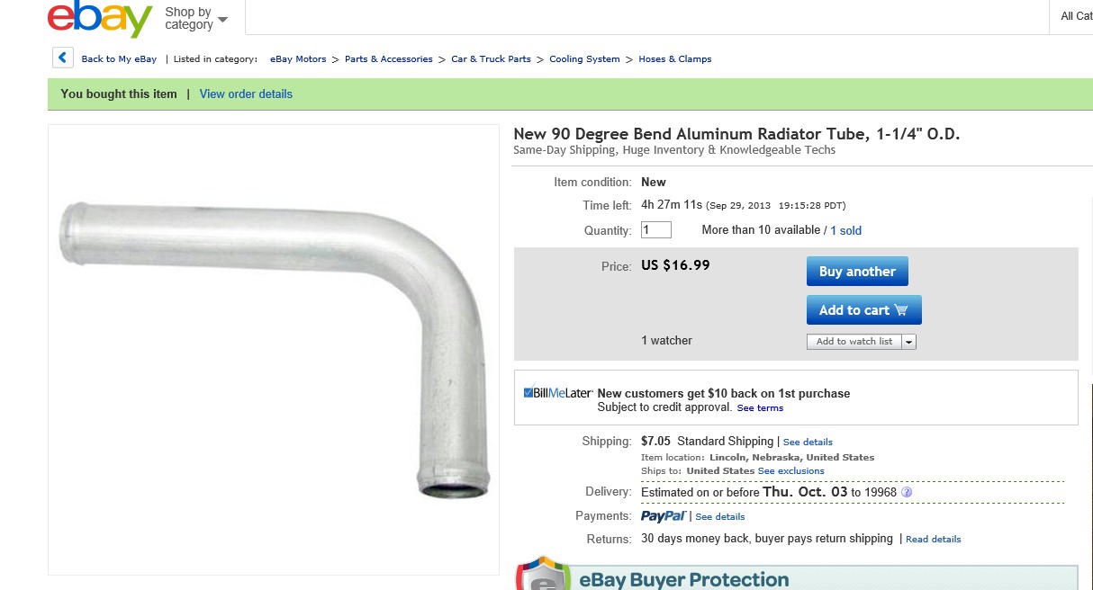

I found this 90 degree 1-1/4 OD bend on ebay and bought it.

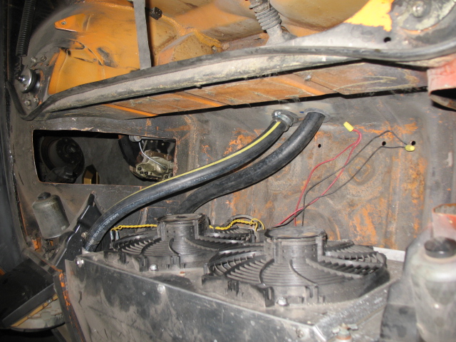

jimkelly   guess i'll run the coolant lines today. the 2...   Sep 29 2013, 08:25 AM
jimkelly   well, not sure I like the relatively short 90 degr...   Sep 29 2013, 03:14 PM
bulitt   I may have to get one of those 90's.   Sep 29 2013, 06:33 PM
jimkelly   since the only electrical connector I have, that h...   Sep 30 2013, 07:32 AM
jimkelly   rcvd the 90 degree tube today - looks good.   Oct 2 2013, 09:18 AM
andys   Much nicer with that aluminum 90! Andys   Oct 2 2013, 09:26 AM
speed metal army   Hey Jim, weather pack electrical connectors are a ...   Oct 2 2013, 10:05 PM

JRust   Yeah the aluminum 90% was a good move. I didn...   Oct 7 2013, 08:11 PM
