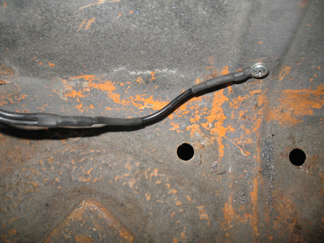

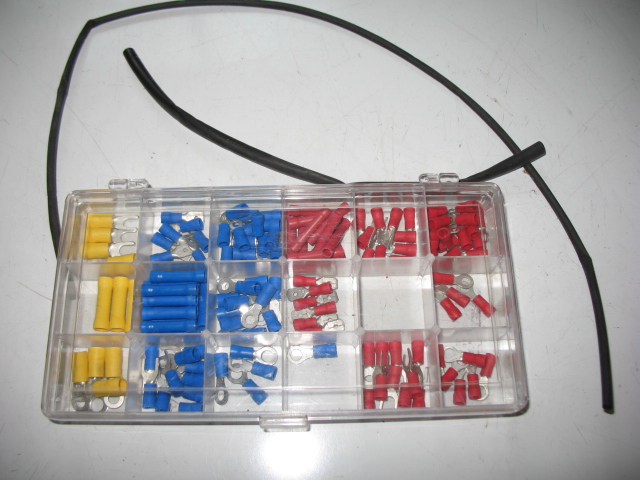

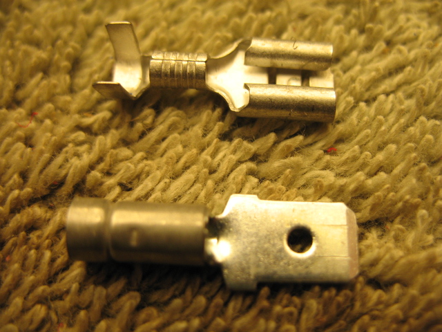

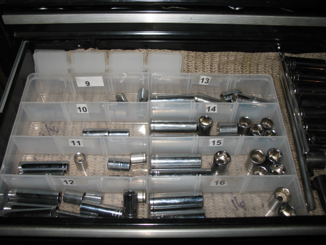

since the only electrical connector I have, that has strain relief, is a female connector, I have been removing the insulators from my crappy connectors, crimping them and then heat shrinking them, to give these single crimp connections some weather protection and some amount of strain relief. like mcmark does, I always try to use narrow heat shrink and on top of that, next size up on all connections.
and today I organized my metric sockets - seems I have a 10mm shortage : (
I still need to organize my wrenches.
