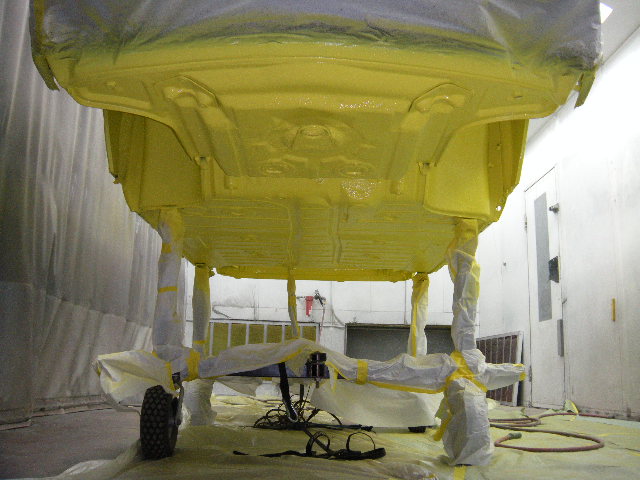

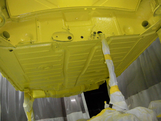

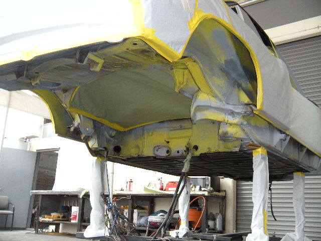

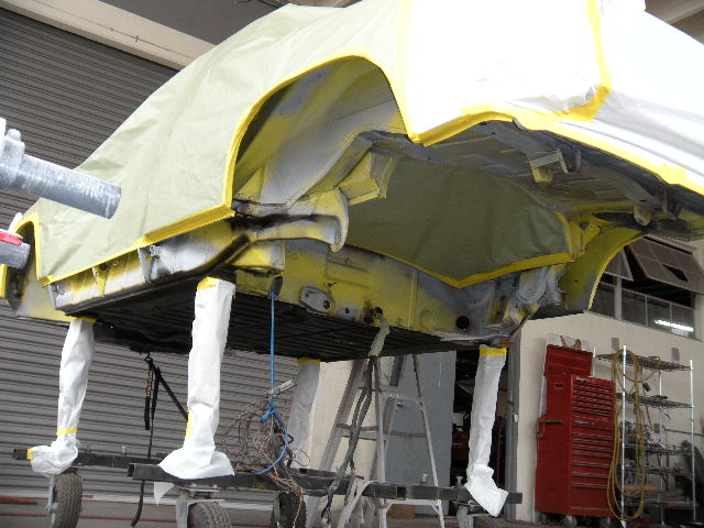

It's a lot of work but I felt it was very much needed to seal it good for good I sanded
and took off the caulking and replaced it with wurth, when that cured, I then shot the entire underside with SKS gravel gaurd and when that cured I scuffed every nook and cranny then painted it. Well worth it for the long run IMO just take your time as the pay off is a good sealed underside. (IMG:http://www.914world.com/bbs2/uploads_offsite/img.photobucket.com-12969-1380588383.1.jpg) (IMG:http://www.914world.com/bbs2/uploads_offsite/img.photobucket.com-12969-1380588384.2.jpg) (IMG:http://www.914world.com/bbs2/uploads_offsite/img.photobucket.com-12969-1380588384.3.jpg) (IMG:http://www.914world.com/bbs2/uploads_offsite/img.photobucket.com-12969-1380588384.4.jpg) Scott |
