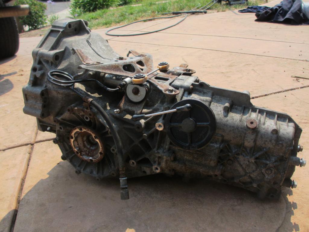

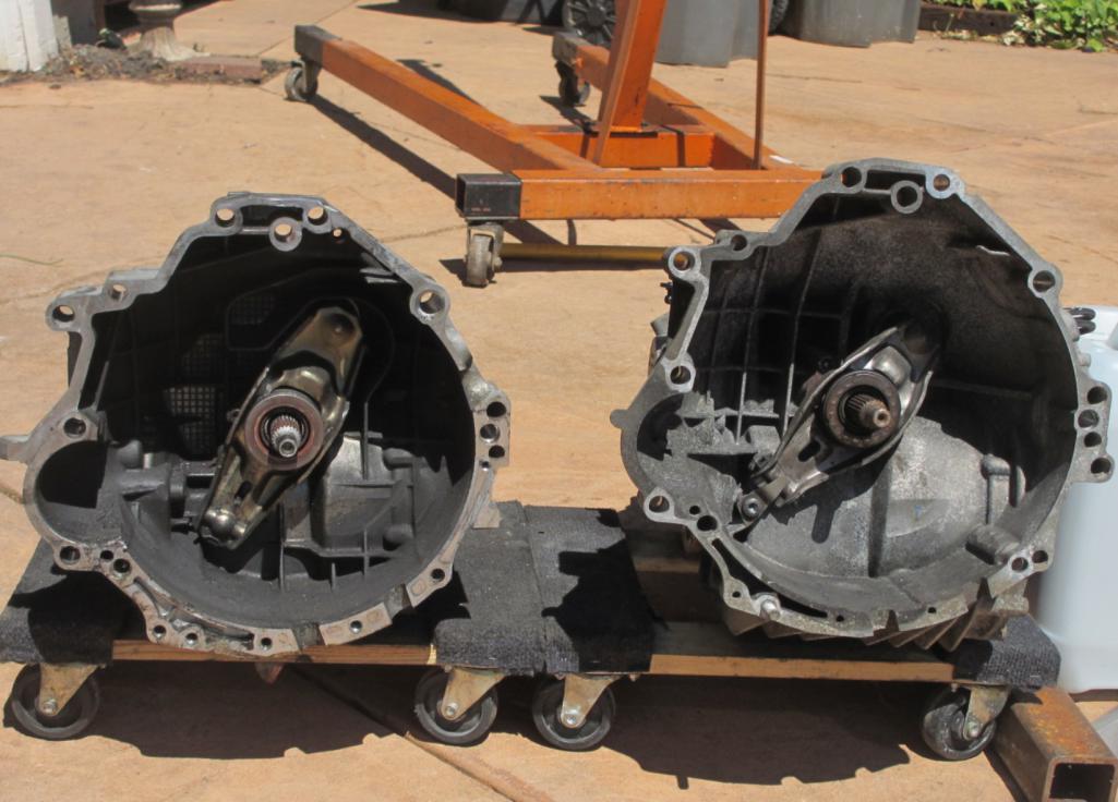

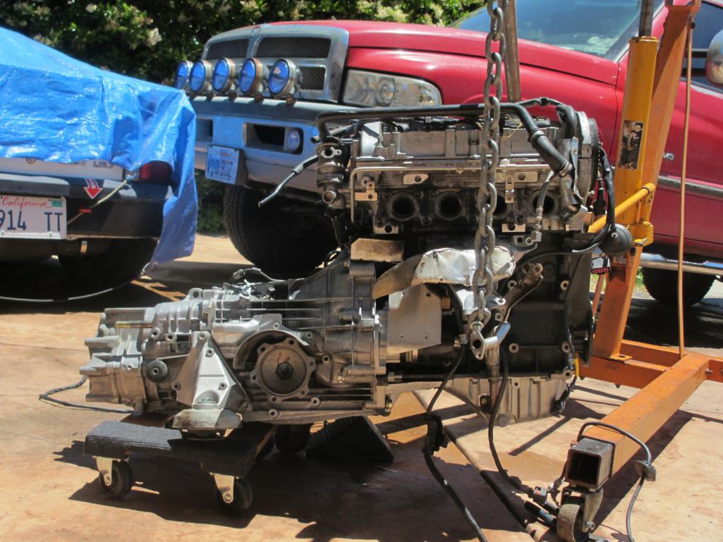

I cheated, sort of. I'm running an Audi 1.8T that happens to have the same bolt pattern as the Cayman S transmission. A direct bolt on conversion. Here is a pic of the engine and the old 5 speed. The 6 speed looks similar...
Here is the 5 speed on the Left and 6 speed on Right
Here is the 6 speed side view.
This is a very similar tranny to the Audi 01E that Andys is running with his LS1 914. The 01E is more pricey and harder to find since it is a Euro FWD only tranny. he Cayman S & Boxster S is a Getrag 466 which is also available with some Audi A8 vehicles. The Porsche version of the 466 comes with 108mm flanges. Not sure what the Audi version comes with. I bolted 930 CV's right to the flanges with 6 bolts in lieu of the stock 930 4 bolts and 2 pins.
Another alternative is importing an Audi TDI 5 speed from Europe. You will only have 5 gears but the ratios are almost perfect for a V8 AND the trannys go for around $400 with another $300 for shipping. Very stout trannys. The TDI 5 speed is hard to find in the US but UK ebay has a ton of them. That is where I got my 466. Mine was $700+$300 to ship.
